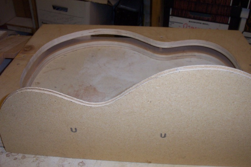

Here, while waiting for my SJ plans, i decided to make the templates since i have Michael's body mold given by Andy Zimmer. Thanks again to both of you!

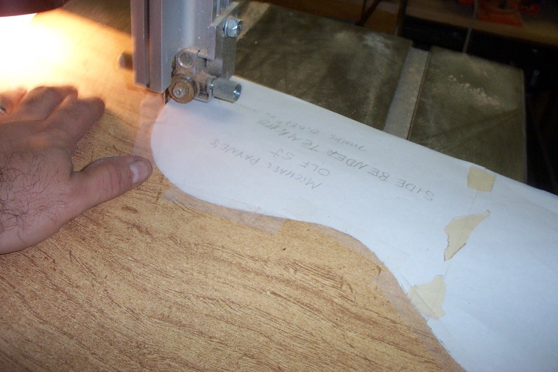

cutting the templates on the bandsaw

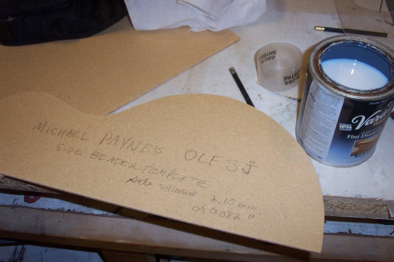

I applied a water base finish to the templates just as a protection since it's very thin
2 templates done, one for the body and one for the side bending machine that is reduced to 0.082" for the thickness of the sides

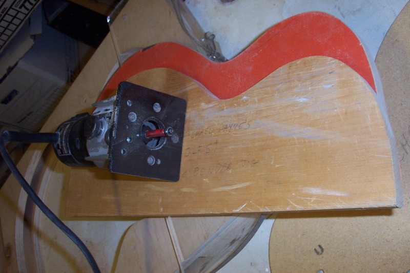

trimmed the excess with my trusty PC 7310
That's where i stopped building and started a huge clean up of the shop or let's say the beginning of another shop makeover, i'll post pics when i'm done with that also

Serge -- thanks for the great pictures! Between the mando and this one you've been pretty busy with jigs.

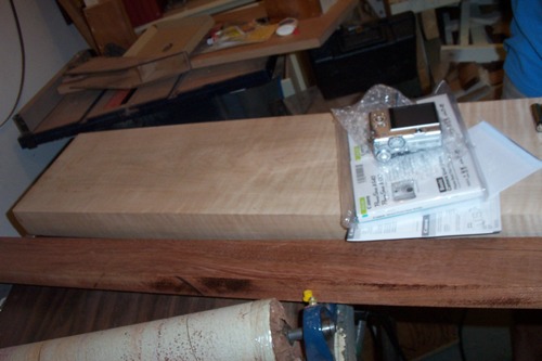

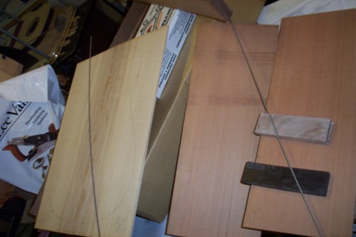

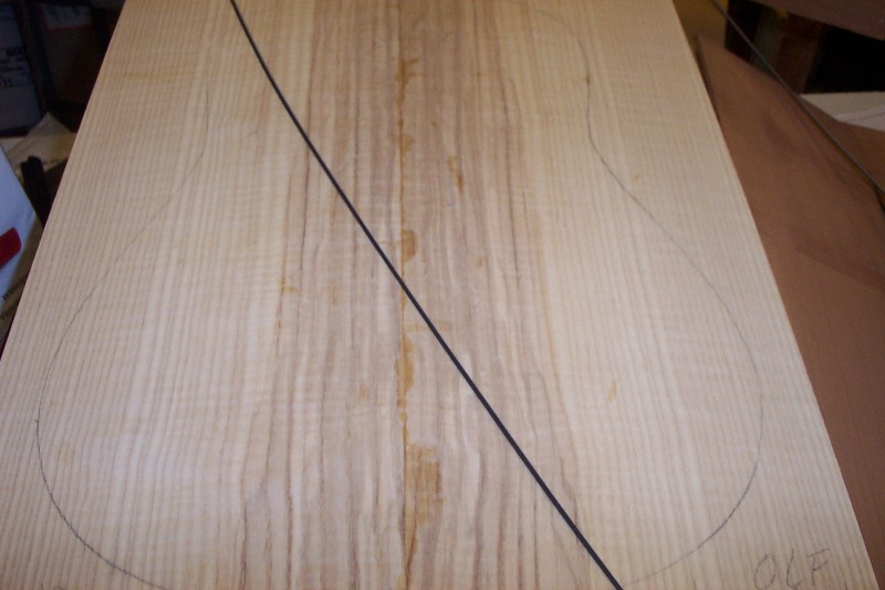

Thanks Hesh and Anthony, no 3 will be made with a red cedar top from Shane and a white ash back and sides from BobC, the bindings will be ebony and the purfs will be rope, both from my pal Russell Rose, for the neck, i plan on using Jatoba, a nice plank that my great bud Alain gave me recently, it should make an awesome lookin' one and it will be made for my Godfather Norman.
Here are a couple of pics of the combo:
Here is the jatoba plank, near the drum of my drum sander

    White ash with cedar and ebony bindings, that's unusual. I've always liked ash! This is going to look cool! I had a Tele in white ash I always liked it!

That's a nice looking piece of cedar you got there. I love cedar.
