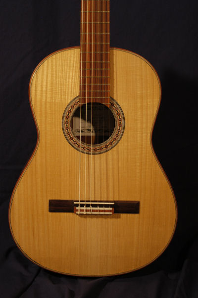

I made a Nylon string classical with Paulownia a few years ago. The tone is really great. The sound is somewhat between Spruce and Cedar. I am currently working on a Steel String version.
The key is to get wood cut from a tree that grows at a high altitude. Most Paulownia at lower elevations grows so fast that the grain lines are at least 1 inch apart. High altitude trees can have up to 10 grain lines per inch. This may not seem like a lot but due to the cellular structure of the wood, it is very stiff. I leave the top a lot thicker than normal and use a flex text to get the stiffness I am looking for. Thickness can vary between .175 to .250 of an inch.
