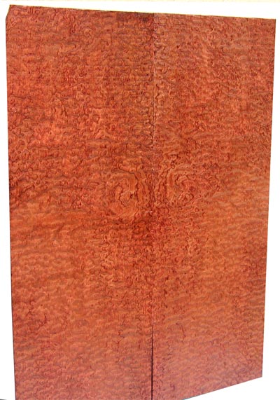

This picture from LMI is probably more like what Todd is refering to...:
The waterfall stuff is reasonably stable. Several people have built with it with fine results.

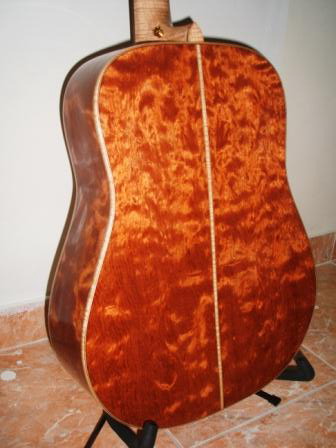

This is a 12-string built with bubinga from LMI, bearclaw sitka top, and maple neck. It is difficult to compare because I don't have my Gibson 12 around. It sounds a little "tight" right now but I expect it will "open up" with more play. I have only had it a month. 12 strings are always difficult for me to compare with 6 strings because they have so many high note strings.
My friend said bending the sides was difficult and comared it to some quilted maple he did for me.
