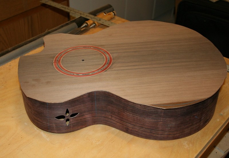

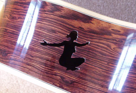

Here's a couple I made.
One is in the works and the other was on my wife's mother's day present!

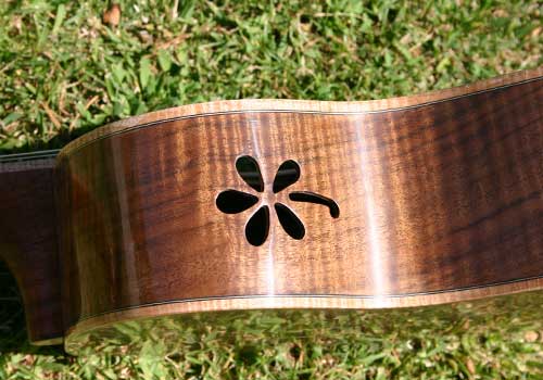

Here's my last one on the irish bouzouki
Those are all great looking sound ports!

PostPosted: Sat Oct 14, 2006 1:29 am
Posts: 1018
Location: Denver, Colorado
I did this one on my last SS. I cut it with a dremel w/ Stew Mac router
base, after bending, but before attaching back and top. I cleaned it up
with needle files and a jeweler's saw.
PostPosted: Sat Oct 14, 2006 2:07 am
Posts: 975
First name: Tracy
Last Name: Leveque
State: CO
Graham,
I bend the sides first, then glue in a 2 layer veneer of black/white using foam and clamps so it conforms to the side. Then process the sides as usual with kerfing, then tape your picture in place and use a dremel to cut out the large areas. I then clean up with needle files to file down to the line. Hope that helps.
