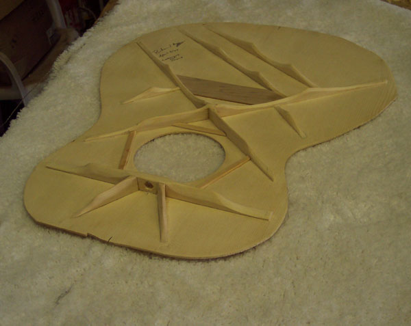

Posts: 749
A picture says a thousand words
As you can see I brace the soundhole and use finger braces for the fret board extension. I ave done L-00 without the Fingerboard support and had no problems but for the little extra work why not. Steve, there is no reason you can't just shift the bridge plate back as long as the bridge still sits on the arms of the X brace but it will mean your fretboard extension will be a little shorter and, IMHO look funny. It isn't an option for me anyway because if I did that the Bridge would not sit on the X brace properly. By the way, moving the bridge back and using a 25.4 scale length creats a guitar with volume and tone that will blow you away.arvey39002.8700810185
