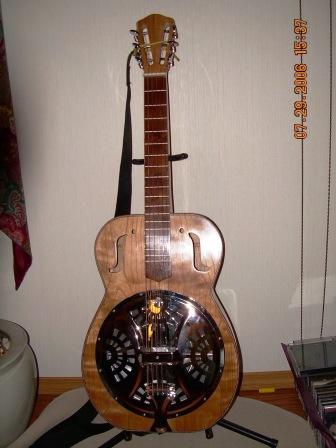

Hi Dave, I have built 2 squareneck resos this year. The strings are set at approx. 7/16 in. above the fretboard at the nut.The bridge is set to keep the same height all along the fretboard. On my first one I inlaid mahogany frets and markers onto a walnut fretboard. It is really hard to see them in dim light. On my second one, I inlaid white ivoroid frets and markers. They are much easier to see.
There is no saddle compensation on a raised string guitar. It is designed to play with a steel bar, and one must have a good ear. The frets are for refrence only.
I am not fimillar with Weissenborn. Do they have a resonator cone? If so, do they ues a biscuit bridge, or a spider bridge? I used spider bridges and Quarterman cones on both of mine. They sound really good.

PostPosted: Sun Oct 15, 2006 12:09 am
Jeff,
Thanks for this.
Weissenborns are the hollow neck guitars and have no cones like these Lazy River ones. If/when I get the hang of these I might venture into the world of "cone" technology.

PostPosted: Sun Oct 15, 2006 12:11 am
[QUOTE=hogan] [/QUOTE]
Jeff,
Lovely looking guitar
PostPosted: Mon Oct 16, 2006 12:42 pm
Yes, really nice indeed!
