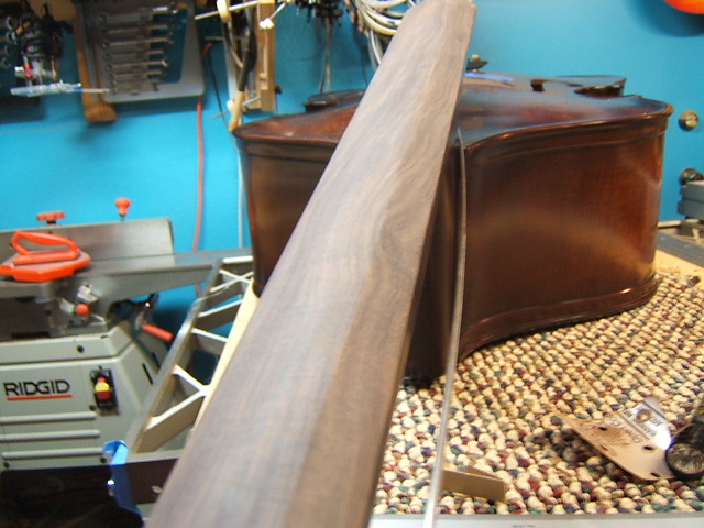

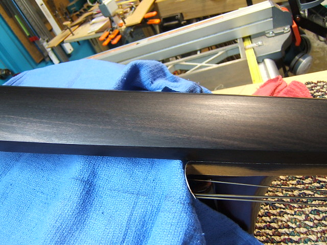

Some Pics:
BEFORE STAIN:
AFTER 4 STAININGS:
PostPosted: Fri Oct 13, 2006 7:26 am
Dave, given where you started I think it now looks great! I see your point about some streaks showing through. Have you let the stain thoroughly dry and buffed it?

I didn't try buffing it as I didn't think that would make it any darker and felt it might even close the pores more and therefore take even less stain...I'm at a loss...I simply don't know what else to do. Sylvan had a great idea using black CA I am going to try that next. I was hoping more people would chime in.
