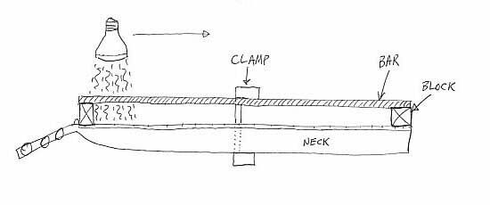

Or you could use the heat and straighten method. This is where you would heat the top of the fretboard using a heatlamp and than you make up a clamping caul which looks kind of like this i---i, it's a beam with short columns at each end. You place this on the fretboard with one beam at the nut end and the other beam of course out at the opposite end. You use a clamp in the middle to correct the bow once the heat from the heat lamp has soffened the glue between the neck and the fretboard.
Here is a link to some more information about bowed neck repair.
Here is a rough picture stollen from another guitar forum on the heat lamp bowed neck repair.
Rod True39006.0072800926

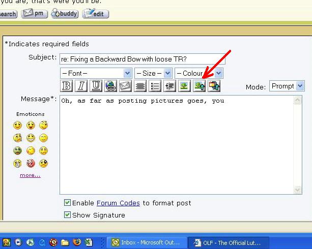

Oh, as far as posting pictures goes, you use this button
to get pictures from your harddrive onto the forum, make sure they are 640x480 as this usually will fit the screen well and also make sure that they are under 150k in size.
Hope that helps.

yes, i think a tr can remove that much relief, though to do so it is advisable to use a clamping set up such as you illustrate to slowly straighten the neck a bit, then adjust the rod whilst the tension is held by the clamp, snd repeat in stages.
if you use heat, the heat must be applied over the length of the fb/neck joint. to apply the heat in only a small area as you illustrate won't do it. if using a lamp, the heat is applied over the length of the neck, then the clamps are applied after the neck is hot.
whilst when i started a lamp was the most common method, along with an alcohol lamp, i've been using a heating blanket for quite a few years.
PostPosted: Mon Oct 16, 2006 12:43 am
Michael is correct in that you need to make sure the entire run of the neck/fretboard is heated. I see that I wasn't totally clear with that detail.
The sketch isn't my own, rather one taken from another website.
The heat blanket would be a great idea of course, if you have one the width of the neck, otherwise I would think the wider ones, for side bending would be to wide and long and would really damage the finish when drooping over the sides of the fretboard.

1) Is this procedure under the assumption that the finger board has the bend creating too much relief or both neck and board?
2) Am I essentially just loosening the glue and pushing up attempting to have the new position hold straight by virtue of the glue holding or am I actually using heat to bend the neck and fingerboard wood?
3) What kind of heating blanket do you recommend? Assuming I complete this project my next thought was to build an accoustic and bend the sides. If I'm going buy a blanket, it would be great to use it for both purposes (noting the above cautions)
Thanks! Sorry for all the questions
PostPosted: Mon Oct 16, 2006 4:27 am
1) It is most likely the neck, not the fretboard, usually there will be some back bow because of the frets being "forced" into a slightly smaller slot that the outer dimension of the fret tang & barb.
2)I'm not entirely sure, but I believe that you will be straightening the neck so as to correct the bow in it, not to try and make the neck conform to a straight fretboard, I think that may be nearly impossible as the neck is stiffer and stronger than the fretboard which is thinner than the neck.
3)LMI sells a blanket for fretboard removal, but it is a different size than the blank for bending sides. I sure you could use the side bending blanket for loosening the fretboard, but I don't think I would do it personally. I would use the heat lamp method if you didn't have the proper heat blanket. You will have to decide this for yourself.

Just to clarify the way the heat bend method works. You are in
essence taking advantage of the heat sensitivity of tightbond (or
similar yellow glues) these glues begin to soften at around 150
degrees. So, you heat the neck / fingerboard joint to allow the joint
to slip slightly when you clamp it. When it cools and the glue cools
and hardens and the neck should hold in its new position. (Hopefully
straighter than when you started!)
This trick will not work on older instruments assembled with hide
glue because hide clue does not creep under heat.
This method is by no means fool proof. You need to get a feel for
where to place your blocks and how much pressure to apply. But it
can work wonders for badly warped necks and necks with no
adjustable truss rod.

PostPosted: Tue Oct 17, 2006 4:24 pm
Posts: 195
Or, you can do what I recently did with an old Teisco Del Ray neck-- clamp it as shown in the diagram above and stick it in your oven at 150 degrees F. Bake for 20 mins, take it out and let cool. Worked like a charm!
