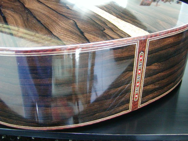

I'll admit I'm a purfling fanatic. This classical I have in progress is a bit over the top with five-line purfling between snakewood bindings and ziricote sides. At least this picture will help you decide if the extreme case is too much for your taste.

Posts: 326
Dang, Gary. You have to warn us befor posting such a thing. I had to shut my eyes hard and grope blindly for my sunglass. Too much purfling? I'll let you know when my retinas return to normal.

Actually I used a welder's mask when installing these purfs .

Gary, where did you get 5 line purfling? Did you make it?

Last Name: Lee
Yes, I made them by gluing standard wood veneers with Titebond II to the plank of snakewood I got at Hibdon Hardwoods. Then I ripped the binding/purfling strips off the assembly. The veneers are natural maple, black-dyed maple, and mahogany.
