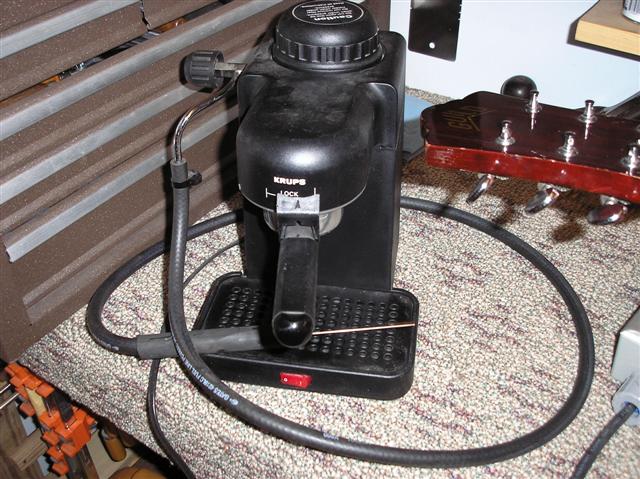

I just started watching this weekends Handmade music. They're following a Gruhn guitar tech repairing a 30's D-18. Pretty interesting the guy used an espresso machine with the steamer running through a tube and a big needle to heat up the glue to remove the neck. Pretty interesting.
Seems like the moisture would cause damage though. nathan c39006.8367939815

Nay, I think that's probably the most common steam 'generator' you'll find in repair shops...
The moisture is just temporary. It's the long term exposures that aren't good (dry or wet)...

years ago we all used pressure cookers as out steam generators. big, heavy, cumbersome, needed a separate hotplate. pia!
the little domestic espresso machines were a boon, though sometimes you have to refill them on difficult necks.
and steaming can result in colateral damage, particularly with laminated b&s, connection to the neck block, and fiish blushes if you are not careful.

Here's what I use.I found it at a thrift shop here for 8 bucks. It does the job. Stew-Mac sells a hose and needle for it.
