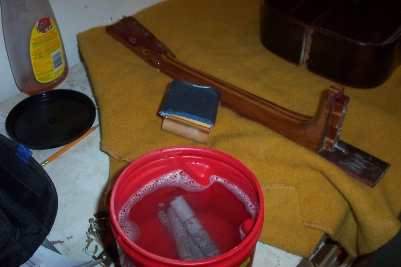

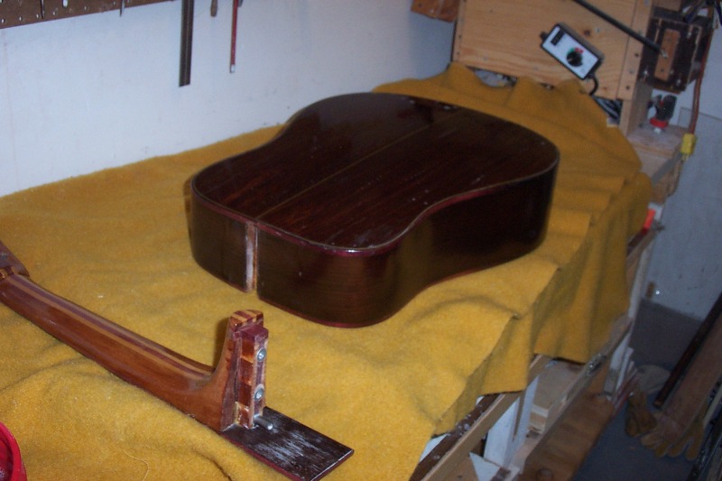

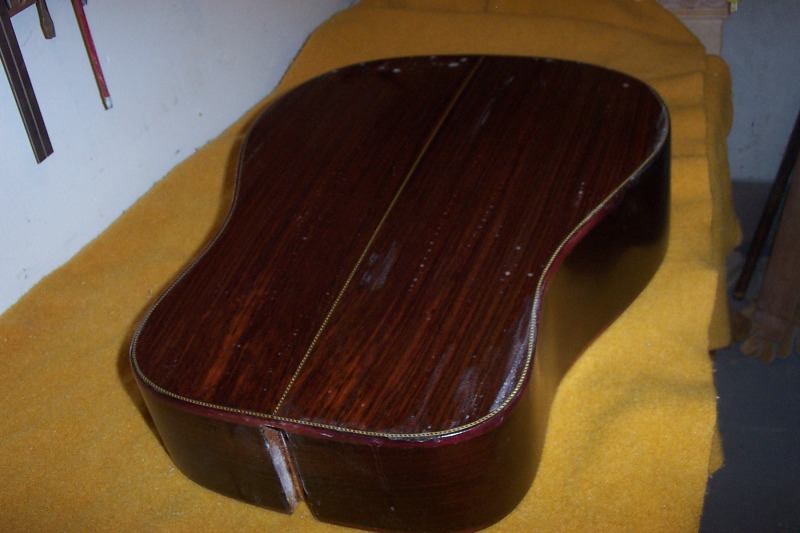

Here are a couple of pics of the wet sanding that i did tonight, i added a drop of mineral spirit to the water, went at it with 6" X 6" area at a time and everything went well with the 600 grits paper, i did the whole soundbox but had to change the water and it was getting late so i'll resume tomorrow night with the neck and one of the sides that has a little ding in it!

Great info Hesh/Rod. It's lookin good Serge!
Rod, on your suggestion to use mineral spirits. What happens if you sand through and introduce mineral spirits to the wood? Wouldn't this affect adhesion when you have to recoat or respray? (Not trying to challenge you here).
I don't understand why wet sanding is so bad? I recently wet sanded an archtop that had 6 coats on it and got it done in about 2 hrs. The toughest part was level sanding the 30 drop fills around the headstock, body and f hole binding area. Listening to some great tunes would have been great (time to get that MP3 player of mine out that I haven't used yet). The next go should be easier (I hope).
PostPosted: Mon Oct 16, 2006 1:14 pm
It was my impression that Rod suggested mineral spirits as a substitute for the water...and adding a drop of mineral oil to the mineral spirits. Did I mis-understand?
PostPosted: Mon Oct 16, 2006 1:37 pm
Looking good Serge!
PostPosted: Mon Oct 16, 2006 2:00 pm
That was correct JJ. Mineral spirits, instead of water and soap. The paper will tend to NOT load up as much, which can cause small scratches if you don't change the paper soon enough.
Mineral spirits, as I understand it, is only a thinner for varnish, not a solvent so it should just evaporate and not effect the finish or wood at all.
I used mineral spirits as the lubricant on the last guitar I finished. I tried soapy water on the guitar previous, but found just like Flexner states, that the paper clogged up to quickly. The mineral spirits was definitely a smoother sanding and the paper did not load as quickly.
PostPosted: Mon Oct 16, 2006 2:07 pm
Duh me -- thanks Rod/JJ. I read Mineral Spirits and my brain translated it to mineral oil.
PostPosted: Mon Oct 16, 2006 2:28 pm
Thanks everyone, the surface isn't shining anymore but it feels like it's getting more even so i think i'll continue the same way untill i get to the 2000 grits.
Anthony, you won't regret having music in your shop bro, a bit hard on the concentration at first but i just reduce the volume then, i don't know how i stayed so long without music in the shop, sooo relaxing!
Thanks again for your input folks!
