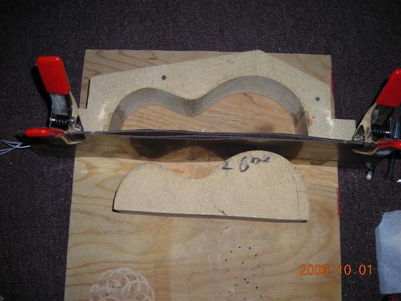

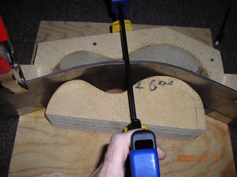

I recently tried a new method of bending for my 2 ukuleles, and I had 0 spring back. I used a thicker mold, about 4 inch thick. I used the inside cutout of the mold to push the sides into the outside part of the mold. I tried it without soaking the wood, and I toasted the sides. I then soaked the wood(koa) for 2 hours, then sandwiched in metal, blanket, side, blanket, metal, then heated for 2 minutes. When I saw the steam and sizzling of the sides I started to push into the outside mold using the inside cutout piece. I also used a quick grip to get it clamped tight. The whole procedure was about 2 min & 30 seconds. I turned it off and waited 2 minutes, then turned it back on for another 1 1/2 min. Turned it off and let cool for 10 min, then placed in the mold and clamped. Very very little springback with this method. A local builder showed me this technique, and he has built over 300 guitars, and has never broke a side using this method. I was amazed! Here are some pics:

Tracy, I was about to build a mold this weekend, and the style you are using does look rather interestin,, and heavy . Unless you hollowed it out. But anyway, you say you use two blankets??? Do you feel that is needed with this style.. It sure looks simple, and I think it could be modified for a cutaway,, hmm I'll have to look at that.. Maybe it would have to hinge.

That thick 2 piece bending mold that Tracy shows is similar to a rig made and sold by a guy called mandomaniac.
