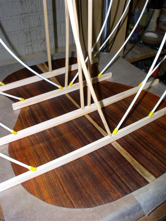

I know, big deal, we have all braced a back
Thought you all might like to see it anyways..
This is for yet another LS redwood topped OM guitar...
This particular set of Coco is way different than any other I have worked with. When I wipe it down with DA, it actually stains my hands with the resins.. Right now my hands look like I just finished staining my outside deck It powders of orange when sanded, its just weird.. Dry its not so pretty, but wet its gorgeous.
PostPosted: Sat Oct 21, 2006 12:15 am
Hi Lance,
Is there a reason you use the wooden dowells in the center or did you just run out of the white fiberglass??
PostPosted: Sat Oct 21, 2006 12:20 am
I find that if you use wooden dowels for the center rod, it imparts a woodier tone to the middle registers of the guitar after its done, that AND I ran short on the fiber glass ones LanceK39011.390150463
PostPosted: Sat Oct 21, 2006 12:50 am
Posts: 954
Lance do you use a center back seam piece, or just the ladder bracing?
Greg
Gwaltney Guitars
PostPosted: Sat Oct 21, 2006 1:01 am

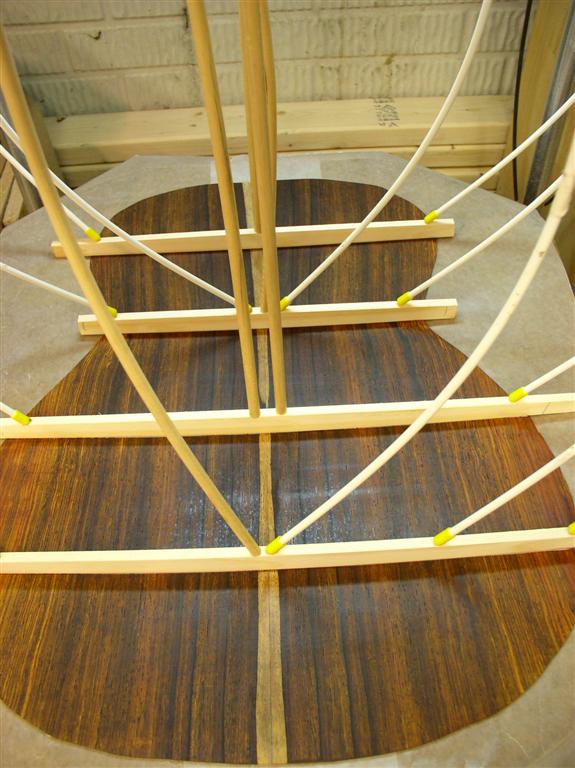

Greg, I will add the center reinforcement after the braces are cut and sanded.
I tape off the back around the braces, then plane, chisel, and sand, remove the tape, and glue in the center piece.
I have not yet decided which way I prefer. Obviously its easier to get the center piece straight doing it first, but then you have to work around it when shaping the braces, and its so delicate that if you bump it with a plane, it dents. I have a large batch of guitars going right now and I'm doing it both ways to try to decide what works best for me.

I like to brace the back first and add center
brace strip after. Just as you are doing.
To get the strip straight, I use a notched radiused
(same as the back 15') straight edge as a guide.
Hope this helps.
