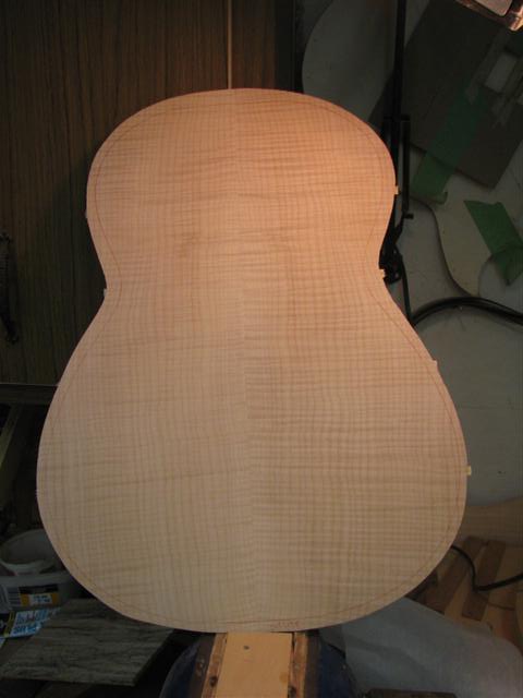

Second is for myself (Yaaaaaa!) I took Dave Whites advise and well, I've thought about it for a while now too so I'm building a maple/cedar 000. Curly Maple b/s and a nice cedar top all from CV Tonewood, right here in my neck of the woods.
So, here are the pictures.

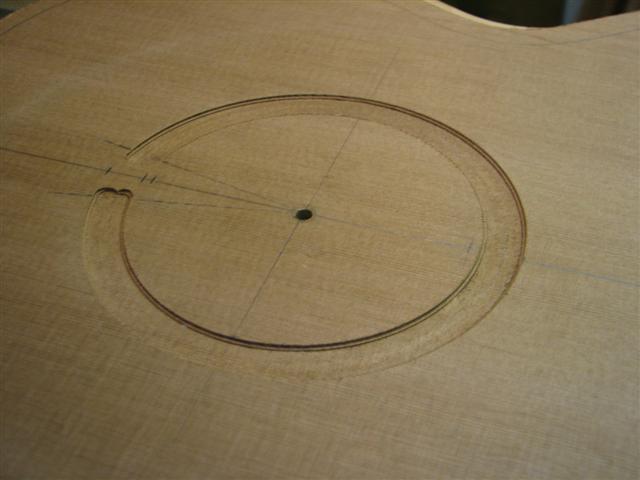

Oh, before that, I have to thank Tony Karol again for posting his circle cutter, Which I copied thankyou very much. This thing works sooooo good. If you are in need of a circle cutter, this is the one for your. Build it and they will come....er whatever. As Tony said "your rosettes and sound holes will be happier". So far, so good.
The channel for the celtic rosette. I cut two channels, one for the rosette, so it would be centered and a second one slightly shallower for a black edge so the rosette would look like it was all surrounded in black

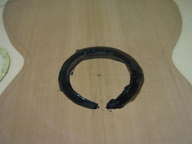

Black epoxy in the channel.
And the rosette set in and pressed down in the go-bar deck (24 hours is going to be a long time to wait )

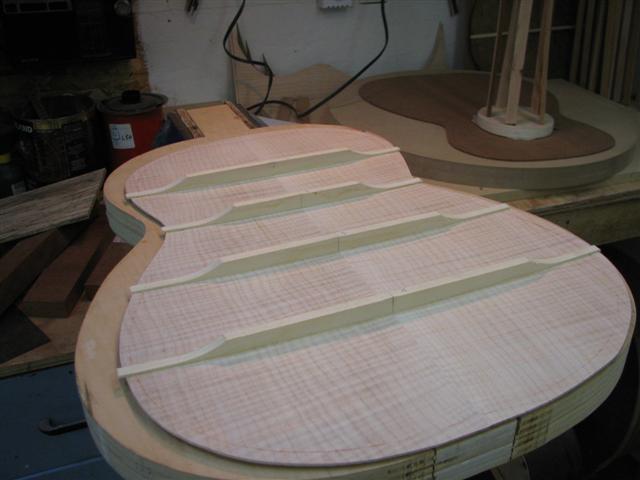

And for the second, Here is the back joined and braces glued down (Ala, Lance K style, trying it out to see if I like it too)

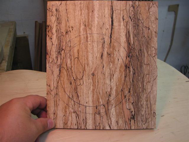

And this is what I'm planning for the rosette, with some b/w/b purfling lines on either side in the cedar top.

Oooooooow look'in good there Rod, love the cedar, nice and tight and the maple looks excellent. So tell me, did the maple come from CV as well??????

The only advice I would give is brace the cedar top for optimum tone as you would with any spruce top, and use hhg as although I was sceptical for the claims at first, I now think it aids the best tone and also structural integrity.

Looking good Rod. I like that chunk of spalted wood, gonna be nice.

Love the spalted maple rosette! I hope you'll continue the thread as it

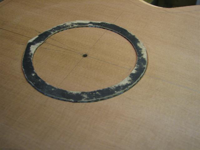

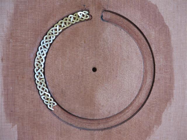

Well as any rookie would do, I pulled the clamp off and took the backing paper off. Well of course, because this is gold MOP (which isn't gold all the way through) I had a white MOP rosette . So I had to pull all the pieces out (I think there are about 200+ pieces in the rosette) and clean them all, and the slot and now I'm doing a jig saw puzzle . Learning the hard way, again.
Here's the puzzle progress so far.
If it doesn't turn out so well I'll just route it out and get a new one. It won't be as good as Andy's initial layout, but I'm hoping it will still be good. There are some larger gaps that will get filled with black of course, but if they get to big, I may just redo the whole thing.
I will post a pic of the completed rosette when it's finished hopfully later this weekend.

The backing paper is more of a thick, solid cardboard about 1/8" thick. What I was doing before I knew that the pearl was gold on one side and "white/natural" on the other was to cut the channel as shown above, trial fit the rosette, (this is the backing paper)
Till it works, it's hard because all those little pieces are glued to the backing paper which is very ridgid of course. The best thing would be if Andy were to mount it with the backside showing, not the show face, than you could just inlay it into the epoxy like I was trying to do.
I would think that the way to do this is the glue on another piece of backing paper to the show face, remove the original backing paper and inlay in the epoxy which should fill all the voids. That was the idea, but it didn't work out so well for me.
So, now i do this jigsaw puzzle of sorts and than flood it with epoxy, let it cure (I'm going to give it 48 hours) than sand it down to 120, blow it out and see if I have any voids to fill.
This could be interesting. Someone else has done this I would think. I did initially ask Andy how I should do this, he said cut the channel and "float" it in epoxy. Well, looking back I should have asked some more questions. But I certainly don't mind the trial-and-error method. Rod True39016.8947569444

I sure want to see how this ends up. I have plans to do one just like it. I didn't know all the pieces would have to be inlaid separately.    My owl (that Andy makes)is made of about twelve pieces, but they are all glued together so I can inlay it as one piece. I was hoping this was the same. Everything I have gotten from Andy has been stuck on that black cardboard, but it only needs to soak in warm water for about 3 or 4 minutes to come off pretty clean. Did you try to remove the rosette from the backing in one piece by soaking?
PostPosted: Thu Oct 26, 2006 1:59 pm
Sorry Ron, I'm much thicker than that
Nope, should have tried that. So, would all these pieces have stayed intact if I soaked the backing paper off?
Boy do I feel stupid.
PostPosted: Thu Oct 26, 2006 2:06 pm
Ron, the more I think about this, the more I don't like you (just kidding).
I suspect that your correct. I would assume that the rosette would stay intact once pulled off the backing.
PostPosted: Thu Oct 26, 2006 2:16 pm
Well, Rod, I certainly don't know for sure about your rosette. It is so much more delicate looking, but I bet, judging from the pieces I've gotten from Andy, that the whole enchilada would have floated free on its own.
Don't beat yourself up over it, though, I could be wrong.
PostPosted: Thu Oct 26, 2006 2:19 pm
I suspect your right though
It's ok, if it turns out, I will have put together a nice little jigsaw puzzle, and learned some more patience. Everyone can always use somemore patience.
