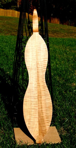

anthony, I can't say which is better since I never tried shelac, but heres a shot of a maple dulcimer which has system3 under KTM-9. the epozy was applied very lightly, just enought to wet the surface. then I went over it with a cloth damped with DA in fp style. Very little sanding required. The maple was a find at lowes..

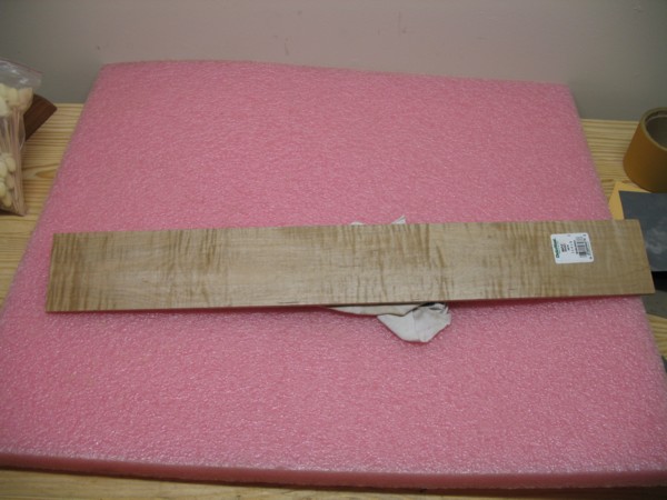

ok, take that back.. I just did, a piece of scrap with 1 lb cut of zinnser seal coat which is 50% blonde and 50% clear.
thats before.. not a ton of figure.. maybe why it was scrap

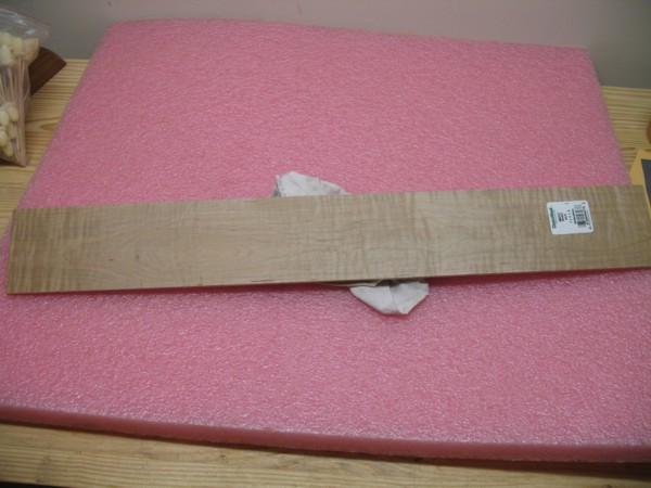

after,,, in my mind, for this test only the epoxy gives it a wetter deeper look.. I think the epoxy gave it more of the amber color too. HTH
