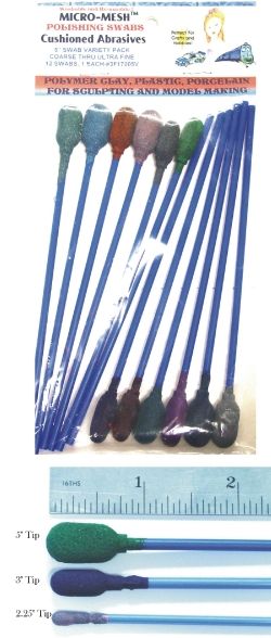

Micro-Surface also offers what looks like Q-tips with sanding pads on the ends
