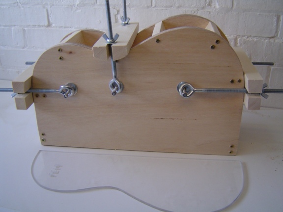

Mario, I am leaning toward a simpler bender too, I have always liked Mike Doolins bender, solid form, and it indexes off the but end. IIRC he starts his bend at the lower bout all the way over to the upper bout, locks them down and then does the waist.

Simple bender here also, only ever use the level of technology necessary to get the job done. This is my simple style, I just make a new one for each body shape. Never let me down, plus you get to feel the wood bend, just like with the pipe, always a good thing especially with difficult woods. Put the swivel ponit for the bout cauls as close to the circle centre as possible.
ColinColin S39015.591875

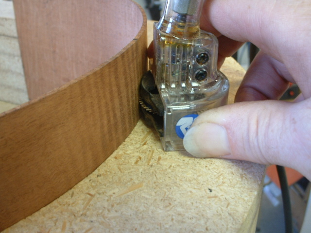

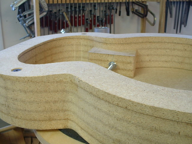

I use my molds to profile after bending:
My back profile is sanded/shaped into a removable spacer, then I trim:
That's a Dremel attachment which works quite well for this application. I've also got a 1/16" slot cutter set up in a lam trimmer which is faster, but I prefer the Dremel setup.
After trimming, I glue in my head and tail blocks, already trimmed to size, then linings just proud of the edge. A minute or two on the motorized dish sander and I'm done. Eliminates any indexing error caused by pre-cut sides slipping in the bender (a problem I used to have).

I forgot to give credit to Charles Fox for my side profiling method. I saw him do it this way 12 years ago; I've been doing it this way ever since. The mold takes a bit more work, but it's worth it in time/aggravation saved later. At least for me
