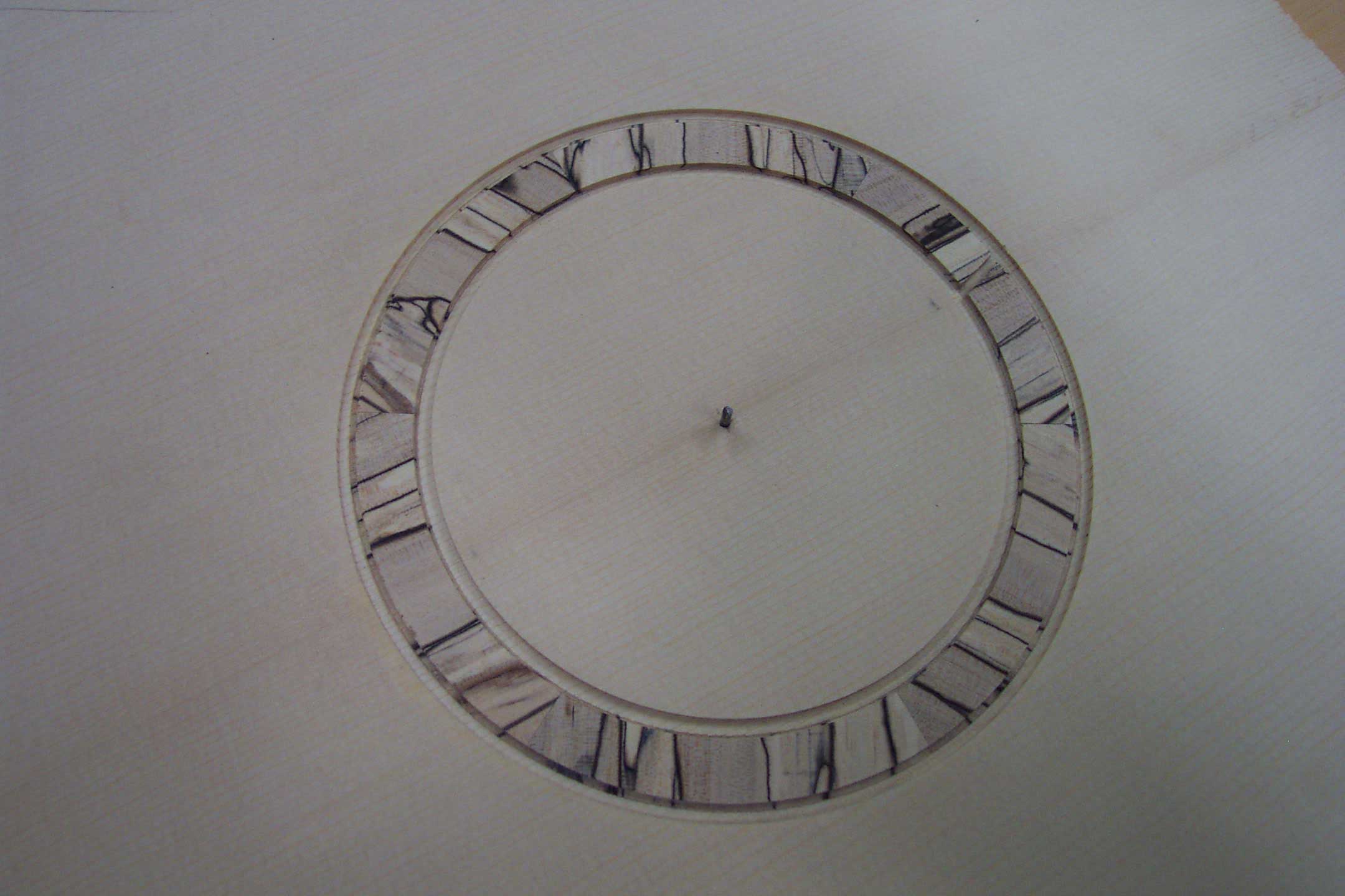

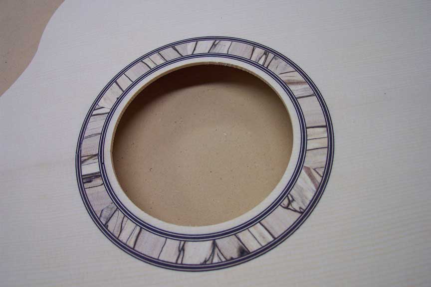

I decided to keep the maple plain. After gluing on the laminations and scraping flush, I started liking the hues that were coming out...
But after gluing it in, I saw there was a small crack. It was only in one section so I still have no idea what I did to cause it...
Needless to say, I was a bit peeved. I routed out a section 1/16 wide and I inlayed a new b/w/b lamination.
Now I just have to scrape that flush and it should be flawless. Still, I'm debating if I want to rout out another 1/16 on the outer edge to have perfect symetry...
What do you guys think? Do I need to match them?
Thanks for looking.
PostPosted: Thu Oct 26, 2006 1:42 pm
Alain, it looks pretty darn good to me with just the extra b/w/b on the inside.
I like the blonde look by the way
PostPosted: Thu Oct 26, 2006 1:43 pm
Posts: 4820
I actually think it looks really good right now.
PostPosted: Thu Oct 26, 2006 2:07 pm
Posts: 993
Alain, I think it looks really good and you did a great job covering up any problems, however, things just don't seem right to me when the purflings schemes don't match. To me, it looks more like an oversight when the rosette isn't weighted evenly.
Cheers!
PostPosted: Thu Oct 26, 2006 2:10 pm
Alain...I like the Maple coloring. I believe it will pop under finish and further differentiate itself from the spruce.
I have to put in a dissenting vote for the heavier outside line. I'm generally obsessed with symmetry and I feel it would be more balanced. When I look at the original with the same purfling lines on the OD & ID, it definitely has a conscious-effort look to my eye.
PostPosted: Thu Oct 26, 2006 2:27 pm
Mark me down in the "add another line" column.
You don't want your bolder line to look like an afterthought, nor your single line to look like you ran out of b/w/b.
Make it look intentional--add that other line.
PostPosted: Thu Oct 26, 2006 2:47 pm
I like the single inside line Alain, it kind of helps with definition of the soundhole.
I also like that you've set the grain of the maple off angle to the grain of the top, and not 90*. I think that is going to look very very cool.
PostPosted: Thu Oct 26, 2006 2:53 pm
It looks awesome Alain, love that maple Man!
i would probably follow Steve's idea for the overall look although JJ's idea of symetry is aso good advice, tough call bro, your call!
PostPosted: Thu Oct 26, 2006 3:28 pm
Looks really nice...I would do the same on the outside too!
PostPosted: Thu Oct 26, 2006 4:07 pm
Alain,
What Steve said.
Perhaps a simulated soundhole, piece of black paper or something black cut in a circle would help visualize how it will look.
Whatever you end up with, I think that blonde on blonde is going to give it a nice, light open look.
burbank39017.0472916667
PostPosted: Thu Oct 26, 2006 4:54 pm
[quote]What do you guys think? Do I need to match them?
[/quote]
   You don't want to know what I think, you wouldn't be able to sleep for a week! But as for the BWB on the outside... symmetry is over rated. Name one thing in nature that's symmetrical.
   I think it would looks good either way, but I'd leave it! I really do like the colors, looks classy.
PostPosted: Thu Oct 26, 2006 11:25 pm
Thanks for your kind words and your encouragement, guys...
I'm leaning towards matching the outside. The purfling had been on the pipe already and it's just waiting for a new channel....
I just hope that everything turns out o.k. I just keep thinking in my mind about the old addage 'If it ain't broke, don't fix it'!...
But you guys are right about the symetry/intentional look of the whole thing... It just grates my nerves knowing that the two sides aren't the same...
By the way, the pictures don't do that maple justice. The piece has blue, gray and silver hues all over!
Cheers,
PostPosted: Thu Oct 26, 2006 11:33 pm
I would not add anything to it.
PostPosted: Thu Oct 26, 2006 11:57 pm
[QUOTE=Alain Desforges] I just keep thinking in my mind about the old addage 'If it ain't broke, don't fix it'!...
Alain,
Another example of historical Chinese whispers. It started out as "If it ain't broke, I'll soon fix that "
I'm in the "dare to be different camp" and would be tempted to leave it as you currently have it. The rosette will be a little too wide for my tastes with the outside done as well. How does it look if you put a black cardboard circle where the soundhole will be.
But then again I know all too well the "niggling voices" that go off in your head when you think something isn't right. They never seem to go away and they stop you from noticing anything else when you look at the guitar.
Either way that maple will look stunning.
PostPosted: Fri Oct 27, 2006 12:05 am
Dave, that's a good point about the width of the rosette. That has been on my mind as well. There's quite a bit of over-hang on that top as it stands now.
I'll try putting a black circle in the middle before I make up my mind for sure...
You wrote, 'If it ain't broke, I'll soon fix that!... I like that!
Don't worry about the voices in my head. With enough Scotch, they can be silenced... Alain Desforges39017.3793981482

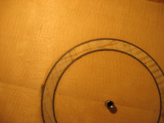

PostPosted: Fri Oct 27, 2006 2:17 am
Posts: 588
For what it's worth Alain,
When I do rossettes like yours, I first inset just the center part then, I do
two seperate passes for the lines. Everything comes out really tight.
I hope this works it's the first time I've sent photos.
long
PostPosted: Fri Oct 27, 2006 2:29 am
Right on Bob! That's a gorgeous rosette, and a great way of executing it as well...
I usually don't have any problems with gaps. This time around, I'm not sure what happened. Maybe the piece moved a bit, maybe I exerted too much pressure on the router. Who knows?
Still, I like your way of doing it! I might just try that next time around. Thanks for the great tip!

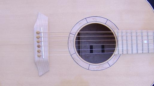

PostPosted: Sun Oct 29, 2006 9:35 am
Joined: Sat Oct 07, 2006 4:06 am
Posts: 29
First name: Karl
Last Name: Dahlman
City: Hampshire
State: IL
Zip/Postal Code: 60140
Country: usa
Here is my attempt at a maple rosette on spruce. I really liked how it came out. I did a maple bridge too.
Hope this pic comes out still figuring it out.
Birdseye maple back and sides too.
