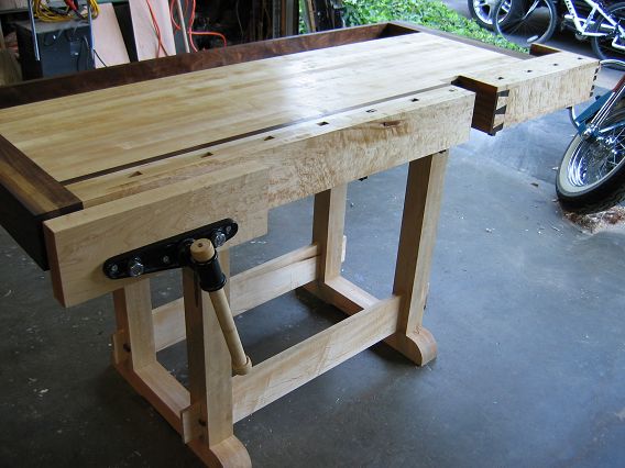

Pick up "The Workbench Book" by Scott Landis. It's a fantastic book. It gives plenty of plans for different styles of bench, but more importantly gives design principles and construction techniques that will allow you to build (or, ugggghhh, buy) a bench that suits your needs.
I think the thing most people miss out on when they buy or build a bench is making it sufficiently sturdy. Woodworking of any kind is so much easier when the bench stays put without shifting or vibrating under any circumstances. For a modest sum, you can build an outstanding, immovable and very rewarding bench that your grandchildren will someday cherish. Here's mine:
I think incorporating appropriate vices, etc. is easy once you have a good bench design to start with.
