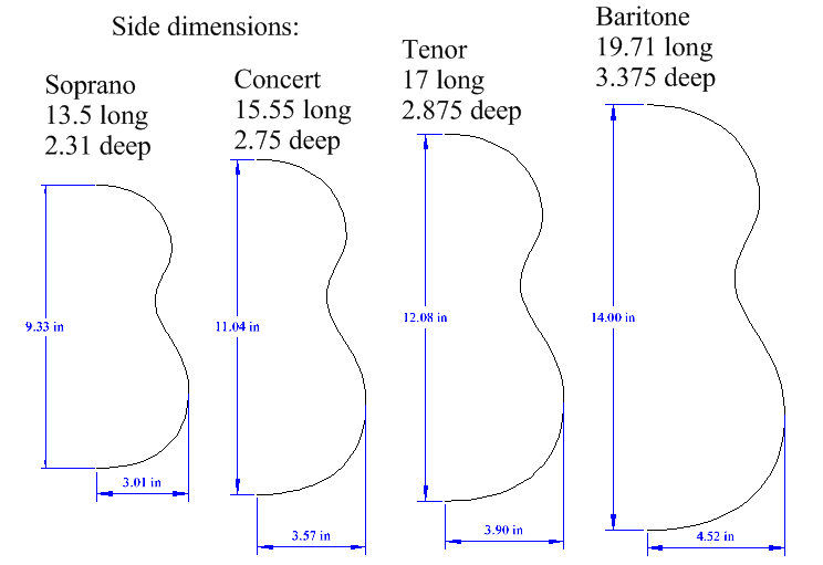

Well, I guess we all have different sizes for ukes, but this is what I go by. The side profiles were drawn out in CAD and the lengths are the exact length of the line, as drawn. So add a bit of length for side blanks. So for example if I am cutting a blank for a soprano side I try to have at least 14".
TomS39018.9556712963
