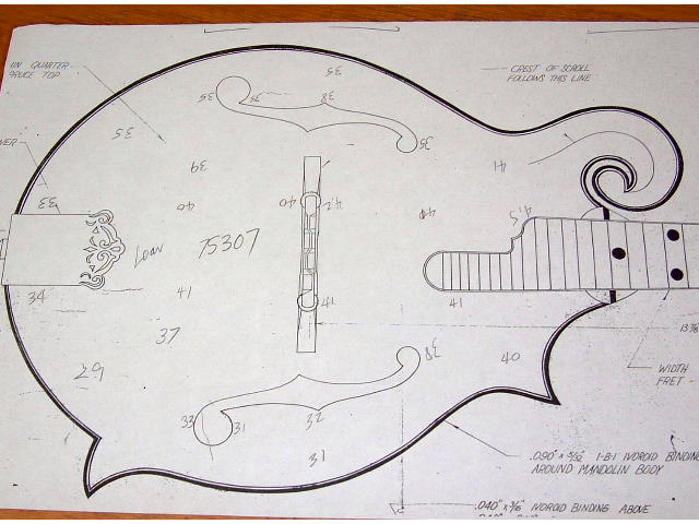

PostPosted: Tue Oct 31, 2006 4:34 am
Posts: 107
Here's a nice little map of a Loar...
