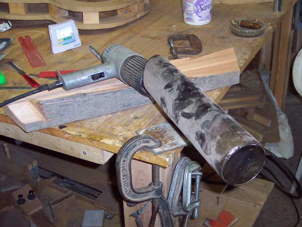

For my bending Iron to took a piece of 2 3/4" metal pipe with an end welded on (it was actually a container for holding road flares) and bolted an L bracket to it. I squished the open end down to give a 1" radius so that I have different radii along the pipe. Orriginally for heat I used a torch but then one day I tried my heat gun. Works great and much safer. Temperatures are between 138C to 160C. I find temp not as critical with the bending pipe as you can control the contact time better than in the Fox Bender. At the same time I mainly use my Fox Bender and just use the pipe for touch ups and cutaways. Here is a pic of my setup.
and another.
You might notice that the plastic on the heat gun melted a bit when I first used it. Make sure only the metal ouches the pipe.arvey39020.6425925926

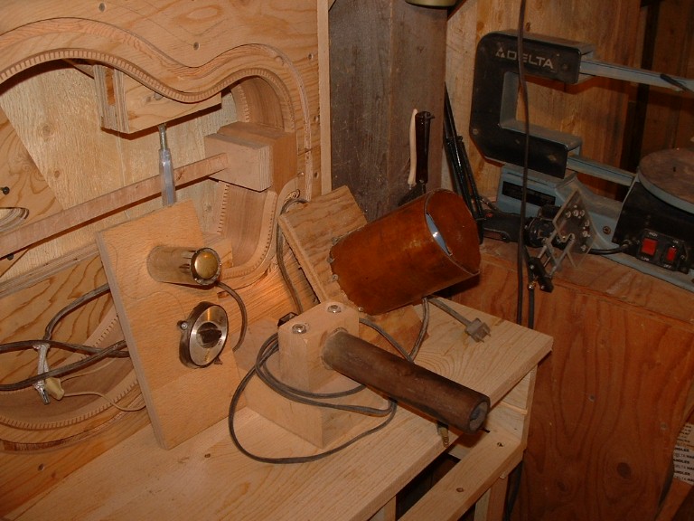

Like most here I use the fox style bender for guitars.
But here's 3 cheapos I have made over the years.
Left to right.
Heating coil from a crockpot wrapped around brass rod
stuck inside a chrome plated brass tube. (sink drain)
Charcoal lighter bent to fit inside a steel pipe.
coiled copper sheet (riveted) and heated with 200watt
lightbulb.
I only use the center one now. And don't forget to use a timer switch for safety. Hope this helps.
