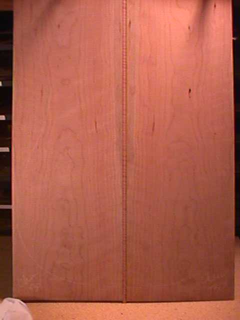

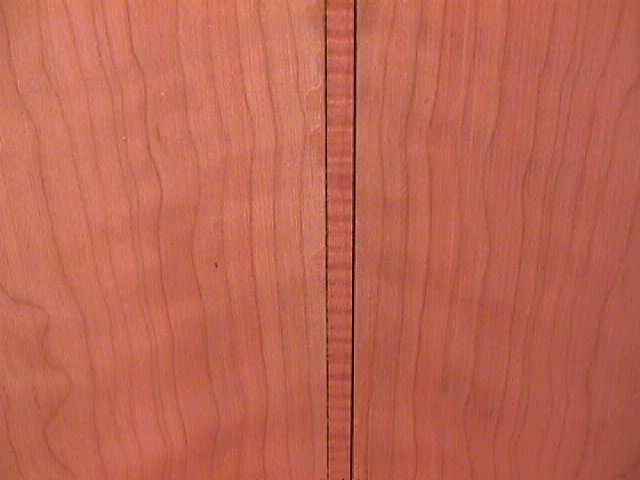

My third going right now is a J-35 style Curly Cherry B&S with a Curly Maple backstrip bordered with black perf on either side.
Close up of backstrip before final cleanup and sanding

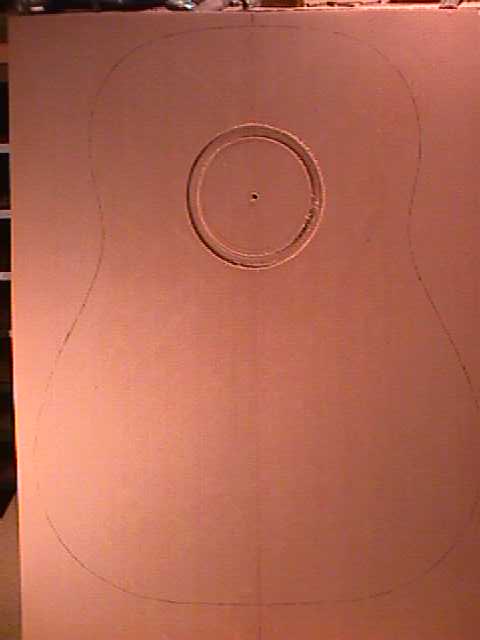

Bearclaw Sitka Spruce top partially routed for rossett

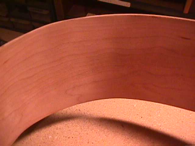

Sides are thicknessed, bent and sitting in a holding mold

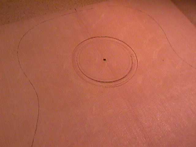

Another shot of the top

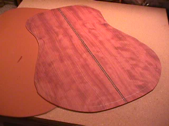

the back

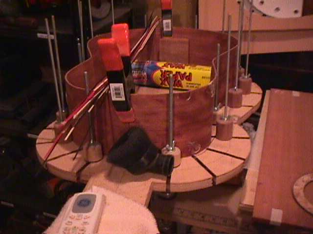

The sides are in the spool clamp work board

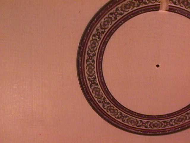

The Engleman Spruce top with rossette inlayed

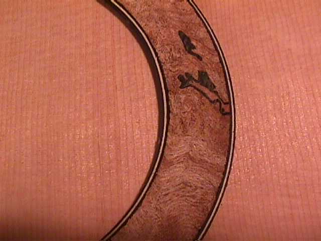

Closeup of the rossette

I'm gonna follow your build with interest; was the cherry easy to bend?

Sam, sorry for not answering both questions, the cherry bends really easy and nice, I thicknessed the sides down to .80 and when it heated to around 240 it started to give, I took it on up to about 290 for the complete bend. You will really enjoy working with this wood.
