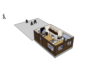

Got my model uploaded into the Google server for anybody that wants to see it. Once you get it downloaded and get logged in, just search for "luthier". As of now, mine is the only one that comes up.
You can download the free software here.
Here's finally a distant pic I pulled off of the Google search. Cool thing is, you can navigate all around this thing and even zoom in until you see the Martin script on the headstock (which I "borrowed" off of the server). You can download this whole shop, modify as your own, break it apart and use the tools where you want... Seriously, y'all owe it to yourselves to check it out.

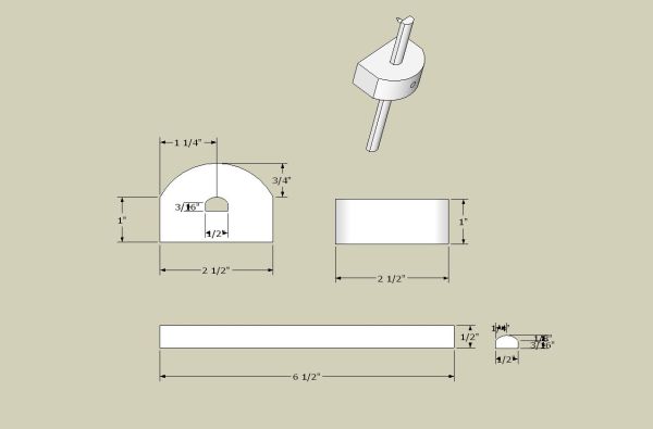

Back in the day, I used to work at a machine shop. I'm used to Autocad and have yet to find an acceptable replacement. That being said, Sketchup is pretty sweet. I made a marking gauge out of bolivian rosewood and designed it in Sketchup.
Here's the sketchup
Here's a post of the completed gauge on a woodworking forum here.nathan c39024.3300578704

Here's some updated pics:

I've figured out how to draw the boxes to the correct sizes,and have my shop's basic layout down, but can I now add the roof on and such? I ask because I'd like to expand the garage out into the driveway(the spray booth sucked up a good portion of it), and I have some roof line ideas I'd like to try.
And how do you get the workbenches and tools in there? I keep thinking of re-arranging the larger tools, and it's much easier to push a mouse than to move a Unisaw....

The shop layout really didn't take very long. It's really just a matter of laying out the foundation "rectangle" the right size and use the "push/pull" feature to "raise the walls". If only it was that easy in real life! You can then erase or hide the roof and/or walls for better access to get around in there. The tools, workbenches, etc, I found on the Google server and just downloaded them into my model. Actually someone else had a fully outfitted shop, which I downloaded, hit "explode" and broke the tools and benches out of it to place in mine.
Mario, I was able to draw up my spring project - a full freestanding metal roof-over on my home - with great detail. I actually have an exploded view that shows the individual scissor trusses, Glu-Lam beams, etc. Really handy for visualizing how the project will go together. I especially wanted to see the finished project to make sure it wouldn't look out of place, as the new roof will sit ~18" above the old, to see how far out to take the eaves to make it blend in seamlessly, etc. I even went inside and drew in my fireplace inside and an outdoor BBQ while I was at it. Priorities, you know.... There's a little learning curve as with all programs of this type, but this one is much more powerful and much easier than the other ones I've tried - and I've got several on my computer.
Easiest way I've found to do the roof is to draw a vertical rectangle at the peak to the roof height. Then draw rectangles from that line down to the edges of the building, select materials and it is roofed with just a click. Then you can delete the extra temporary lines you don't need. I think I saw somebody already had a Unisaw built on the server. Just click the Google tab and select "Get Models" to search for it.
