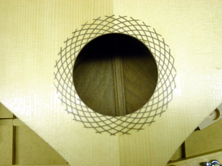

He's the fellow that came up with the Spiro rosette. Remember this?

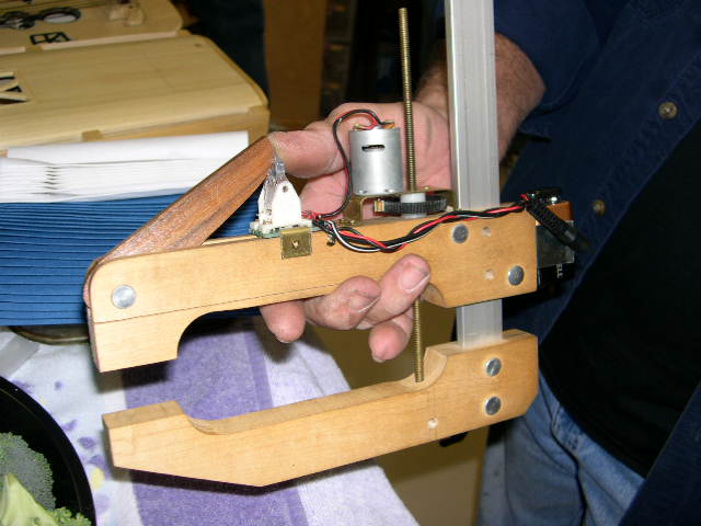

Seems he's always thinking up new (and sometimes better) ways of doing things. Lately in one of those lulls while the glue dries, his mind wandered over to cam clamp design. Useful tools, but they require two hands. Could one be made to operate with only one hand?
And here is his solution:
The operation is smooth and sure. The two-way switch operates that small electric motor. It has a gear which mates to a toothed wheel which is tapped to run up and down a 3/16" threaded brass rod, pulling the upper arm with it.
Here's another shot:

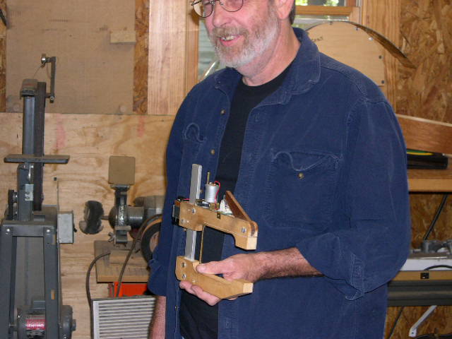

And finally, an almost-good shot of Dan and his amazing clamp:
This was the hit of the last LINT meeting.
