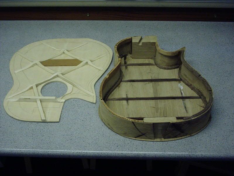

OK, after a few bound builds I've spotted a congenital flaw with using standard bindings.
In ALL of the 6 bound builds I've done (wow is it really six?!!) the binding has sprung a little at the tail. maybe only a cm, but enough to need a drop of CA and a clamp.
Now I appreciate that I'm being driven by Stewmac's binding lengths. they are long enough for 1/2 a top. This in turn is probably driven by the postal service having a price band that limits the length of parcels which MAKES stewmac and all the others cut the binding to the industry standard 1/2 a top length.
For a change ( ) I have bucked the trend. I'm making a guitar for a collegues son. It's an oak back & sides, sitka combo. and I bound it in walnut that had in the store from my last dumpster diving escapade.
I cut it long enough to do a full lap of the top and back.
so now that it's on........
Is there any reason that this would be a bad idea??
