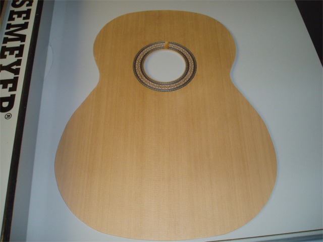

I was able to complete a soundboard on Saturday because HHG is so quick, it's workable in 2-4 hours in most cases.
Resaw-Thickness-Joint
*Glue Joint Plates HHG 3 hour*
Thickness-Cut Rosette Channel
*Glue in Rosette HHG Glue 3 hour*
Scape Flush-Drill Sound Hole-Final Contour Thickness
