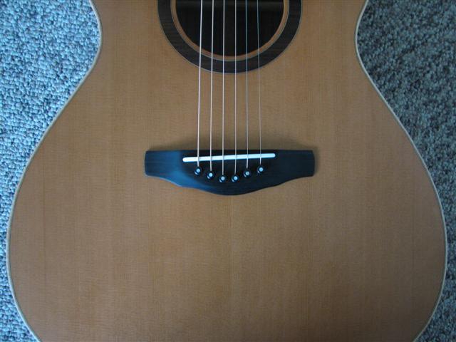

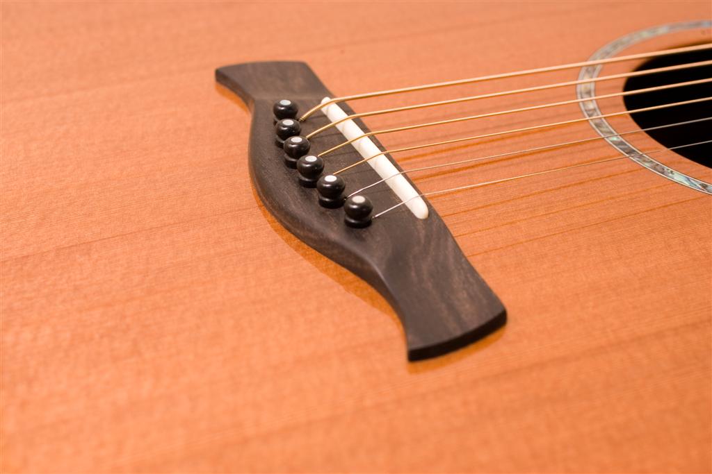

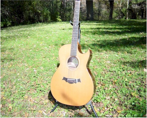

Sort of a Taylor in reverseMichaelP39028.7143865741
PostPosted: Tue Nov 07, 2006 9:17 am

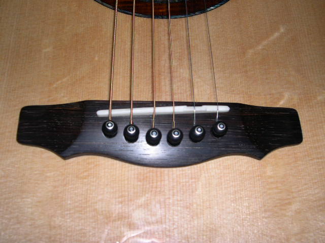

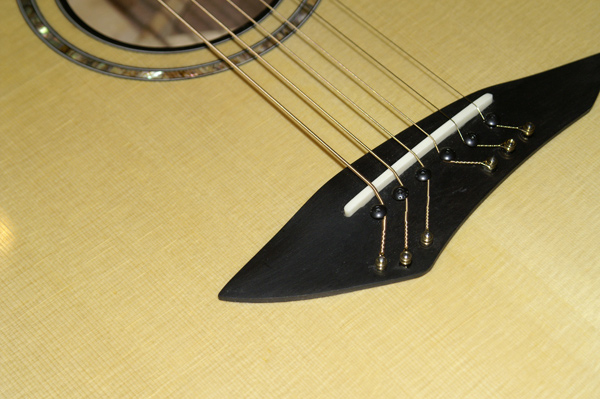

Sort of a mix of a bunch of different designs.

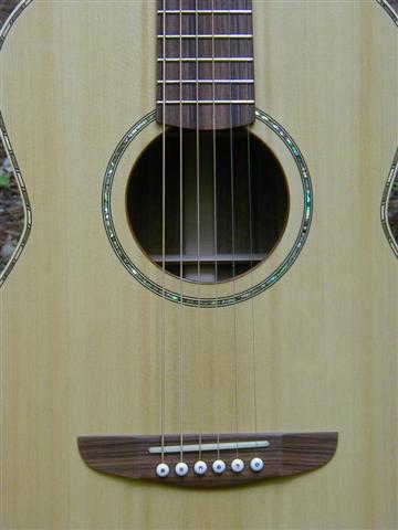

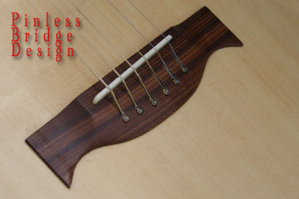

I don't have a close-up pic at work, but I do have this:
PostPosted: Tue Nov 07, 2006 9:23 am
Some of the old timers will recognize the David Russell Young influence on my bridge design.

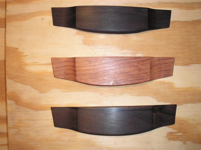

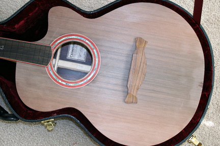

Here are two, cut from the same blank of Mac Eb.
Suddo stolen from Olson, Ryan design's
Rod True39028.738900463
PostPosted: Tue Nov 07, 2006 10:05 am
Ah... thanks man! That's the pic I wanted!
I've since moved away from the 'smiley' holes for the pins, though... (not enough break angle after the saddle that way....)

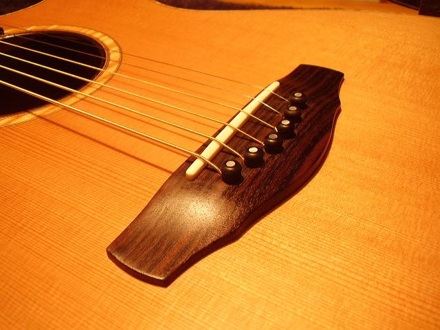

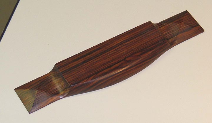

The first is a prototype of my "Pyra-belly" bridge. There's no holes or saddle slot, and the top is a bit flatter than I use, but it will give you the idea. I use it for OM's and smaller-bodied guitars. What I like about it is that it combines the pyramis bridge but has enough of a belly to give a little arch to the bridge pin placement. Here it is:
This one is cocobolo.

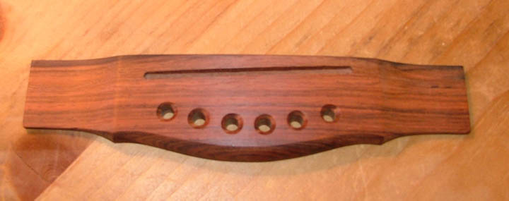

And my standard bridge for SJ's and Dread's:
This one is BRW.
As an aside, making bridges is one of the most fun things in guitarmaking for me. It's a little machining, a little sculpting, and it doesn't take much time to produce something nice.Don Williams39028.7678472222

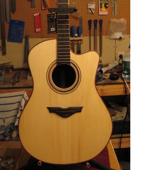

Here's mine...got the idea while I was in Brooklyn...

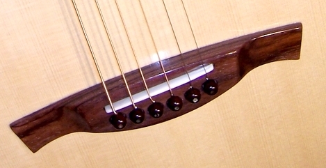

Standard Bridge
LanceK39028.8316087963

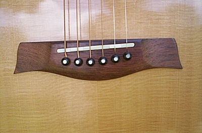

Here are a few I made recently-ebony,bubinga,brw. Kind of like James Goodalls' design.

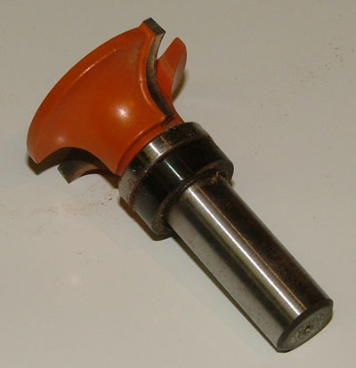

It's actually a partial radius, cut with a carbide bit.
I found a set of CMT carbide bits at my local Woodcraft, and the bit that cuts this was part of that set.
The owner of the store was willing to sell me just the one bit, and he simply ordered a new one for the set.
It's a 1/2" shank bit. Here's a pic:
Don Williams39028.9153125
