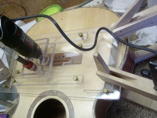

In the beginning, I did just like Cumpiano said to do it but have since tweaked my jig for better results. I can't remember exactly what I did but I use the same jig all the time so don't think about it. See the whole story in the Jigs, Tools and Technique section here.
John How39028.8980555556
PostPosted: Tue Nov 07, 2006 2:41 pm
I'm using the same jig as John How, Andy and it's been nearly two years since I madeit, but I do believe the saddle makes approx. a 3 degree angle with the center line.
I never actually measured it, I just marked where the ends should be (according to my books) and connected those points. Look at a plan and measure the slot ends from the front of the bridge and connect the dots. With a jig like John's, you only have to do this once. Of course, if the front of your bridge isn't square, it will be more difficult.

I started slotting the bridge after it is glued on. Like those who posted above, I have no idea what the angle is.
This is what I do -
PostPosted: Tue Nov 07, 2006 4:11 pm

I use the StewMac intonator thingy after I've glued on the bridge, then
rout the slot accordingly. You can use little dowels or strings or whatever
instead of the SM jig, but it's pretty slick. Anyway, I don't know the actual
angle!
