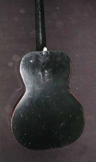

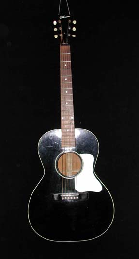

I showed Hesh the bridge on my old L-00 and he asked for more so here
she is. All black and white. It's hard to tell how old she is exactly but the
consensus I've come to accept is 1932-1934. She's light as a feather and
sound like a million bucks. I think it took 15 seconds to go from D chord
to wrap it up for me!!!

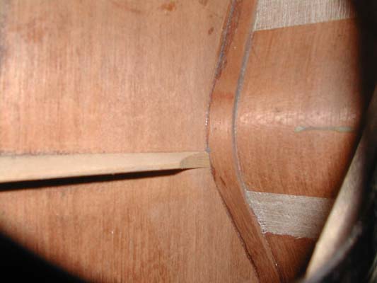

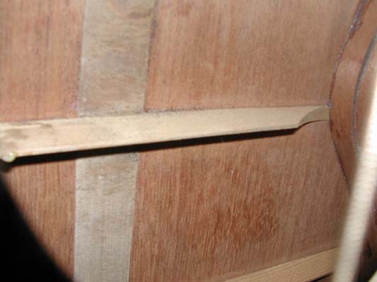

I included a shot of the back braces to give you an idea about just
how light these guitars are braced. I measured all the braces at some
point but I can't seem to find where numbers are right now. I think the X
brace clocked in at aprox. 7mm wide by 15mm tall and they are tapered
almost to a sharp point on top.
This one also has a floating fingerboard extension, almost like a
mandolin. It makes the bridge a bit taller that what you would expect for
a flat top guitar and it took a little while from my right had to get used to
the strings being higher off the body.
Take a look:
Enjoy!
LouisLouis405239030.5373611111
- Louis Freilicher
PostPosted: Wed Nov 08, 2006 4:08 pm
Posts: 296
First name: Louis
Last Name: Freilicher
City: Belchertown
State: MA
Zip/Postal Code: 01007
Here are those braces again!
Louis
- Louis Freilicher
PostPosted: Wed Nov 08, 2006 4:49 pm
Nice.
Got to love the good old days when large glue runs were acceptable eh?
PostPosted: Thu Nov 09, 2006 1:20 am
Posts: 575
I notice the solid linings and the cloth strips on the sides...and the glue run.
Mark Swanson
Swanson Guitars
PostPosted: Thu Nov 09, 2006 1:31 am
Louis, is the bridge laquered like the rest of the gitar or is it ebony? That is a nice looking guitar there.
PostPosted: Thu Nov 09, 2006 1:57 am
Posts: 655
Location: Columbus,Ohio
Does anyone out there do that floating fret board? CLinton
PostPosted: Thu Nov 09, 2006 3:07 am
Posts: 749
I also am interested in the floating fret board idea.
PostPosted: Thu Nov 09, 2006 6:43 pm
Posts: 296
First name: Louis
City: Belchertown
State: MA
Thanks all! She’s a great guitar, glue drips and all. I don't think they are
"all original" because the most of the neck reset is sloppy.
Joe, the bridge is ebonized rosewood. The finish looks different than the
black lacquer on the guitar, but it is shinier than just a stained bridge
would be.
Hesh, I can't wait to see more of your L-00, soon I hope!
Cheers,
Louis
- Louis Freilicher
