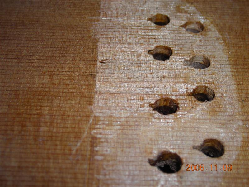

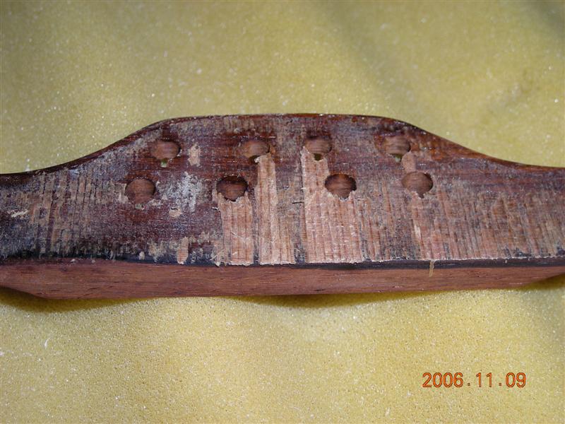

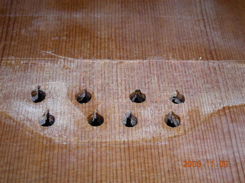

I noticed my Bouzouki bridge was lifting on the edges, so I decided it was a good time to pop it off and refinish the FP top and then reglue. The top is Cedar and the glue is hide glue 192 gram strength. I just used an iron and moist towel to get it off. About 1/2 way through getting it off, it popped up unexpectingly and pulled some of the top with it.
My question is, how do you fill these big holes before re-gluing the bridge? I was thinking of just chiseling out a slightly bigger area to clean it up and get rid of the rough edges, and just glue in another piece of cedar, and sand down flush and start over. Is this the preferred method?
Here are some pics:

this is probably a result of too much levering upward with your removal tool. when removing i try to get the tool to pass entirely under the bridge to completely break the glue line, leave it in place and slide in another adjacent to it, and so forth. sometimes i end up with five or so pallette knives sticking out from under the bridge before it comes away. but you don't end up losing top wood.
but to your problem; as the wood loss is on the front edge, you can probably get away with not worrying about it and just reglue. the stress will be mainly on the back edge which appears to be intact.
if you elect to replace the wood you could make a small inlay pattern guide slighly greater in area than the wood loss, then use an inlay matching bit and guide to route out an area to the greatest depth of the wood loss, route a matching patch, glue in, and smooth, then reglue your bridge. make the guide so that the patch edges don't follow grain lines or cross at lines parallel to the straight edges of the bridge to make its removal less likely if the bridge ever has to be removed again.

Epoxy, sawdust and/or inlaying new wood is not recommended and is not necessary in your situation.
The preferred approach would be to remove the splinters from the bottom of the bridge and glue them back into the voids on the top as carefully as possible. Clean up the top by scraping the bridge footprint with a chisel. Then reglue the bridge with HHG.

The reason the bridge probably came up is you did not have the finish removed all the way to the edge of the bridge. You can see a 1/16" strip of clean bridge around the perimeter where there was no adhesion to the top. This creates a stress riser and can lead to the bridge peeling up, especially at the back edge.

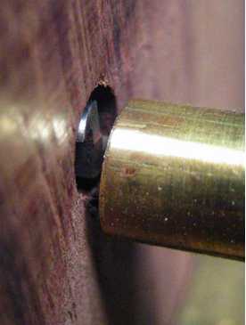

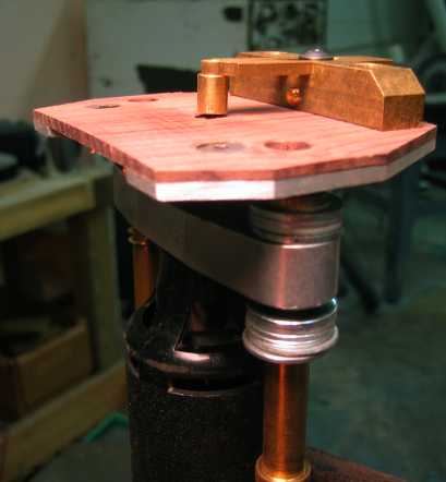

I suppose I should show the tool I use. Since I never use my dremel for
anything else I converted the StewMac base and binding slot jig to a single
use tool for this. I put the rosewod cap on the base to give me a radiused
surface, otherwise you could only use it for perfectly flat bridges. It's very
easy to adjust for individual instruments.

Now to fix it...I'll remove the slivers of wood from the bridge very carefully and glue them back in with HHG. I'll try to get most of them in, but not all of them. I'll then sand flat and clean up the rest of the bridge area with a very sharp chisel in a scraping action. I'll also remove more of the finish on the back side of the bridge area so there is more contact on this back side. (just for reference, the back of the bass side wing, was the first to come lose, then it started working its way to the back edge). It will be awhile before I glue it back down because I plan on refinishing the top with FP.

Hesh, I think you've got how I use it right, and I just use a straight 3/16
striaght bit in this case. At a cutting depth of less than .010" I doubt that
the upcut or downcut spiral would make any difference. The Jig I
used before this used an old laminate trimmer and a 1/4" bit. I built a
small router table, if you could call it that - more just scraps of wood
made in to a box with the trimmer mounted inside. Then radiused the
"table", bolted a piece of wood with a 1/4" pin mounted in it as a guide.
The clearance holes in the guide block can be more than enough slop to
adjust the inset depth of the cut. Then the height was just adjusted at the
trimmer base.
The cut usually ends up at about .003"-.005" like you said, although I will
often make the initial cut slightly deeper to allow for a few thousands to
be scraped before glueing.
It's a really easy jig to make. You can take any router-like tool mount a
plate to it's base or the base to a table, and make some sort of a depth
stop. There are plenty of other approaches to a tool for this purpose, and
I used this design based on the materials at hand.
