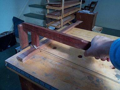

I remember seeing someone's take on a fret press that was so simple it made you go "Duh". It was made of wood. It used the cauls that Stew-Mac sells and an hinge. I will see if I can dig up the photo I hope I squirreled away somewhere.
PostPosted: Fri Nov 10, 2006 4:48 am
Okay, they say the memory is the first to go.....
It does not use the Stew-Mac caul, but it could be modified to use it.
The shoe is a piece of aluminum angle that is loosely pinned so that it can find where it needs to be and not force the fret in at an angle. The designer feels that this jigs gives you a better feel of the frets as they are set.Aoibeann39031.5351157407
