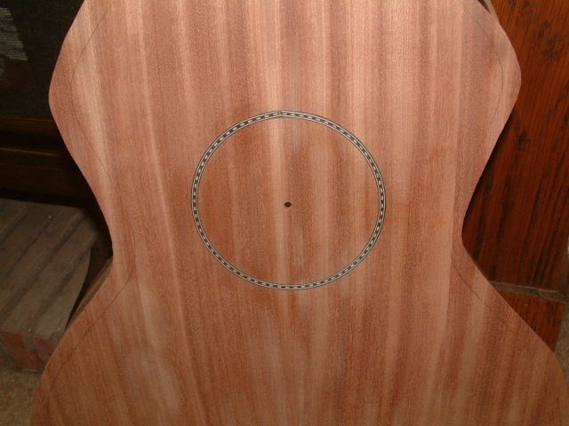

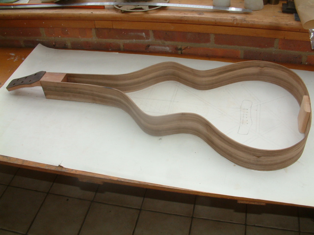

Here's the latest creation taking shape. A first for me as it's a Weissenborn type acoustic lap-slide. As a prototype, I'm trying to make it as much as possible from odd pieces of wood I have had around the workshop for a while. So it will have English walnut sides with Sapele top and back. The top and back will each be 4 piece.
Here's the rim set with peghead attached - a totally new experience in neck building for me:
The top rough cut with rosette installed:
A closer view of the rosette:

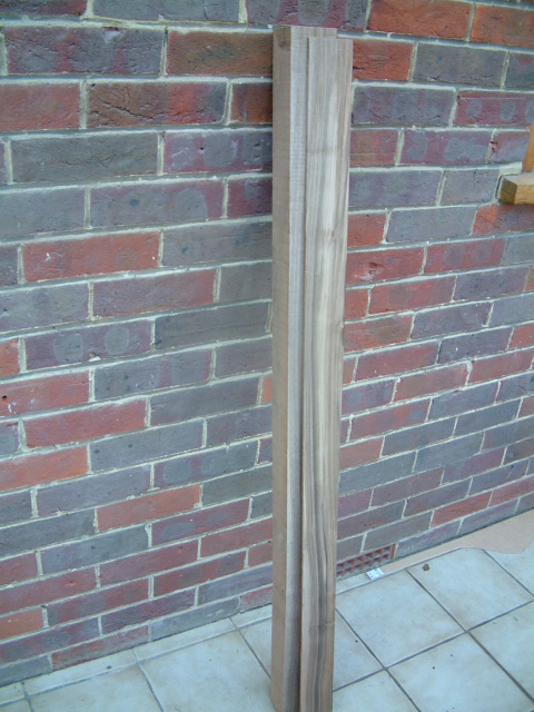

Colin - No. I bought some walnut pieces from Isaac Lord here in High Wycombe a few years back including a long 3"x3" piece that I thought would be useful for necks and binding. It's perfect for Weissenborn sides:
