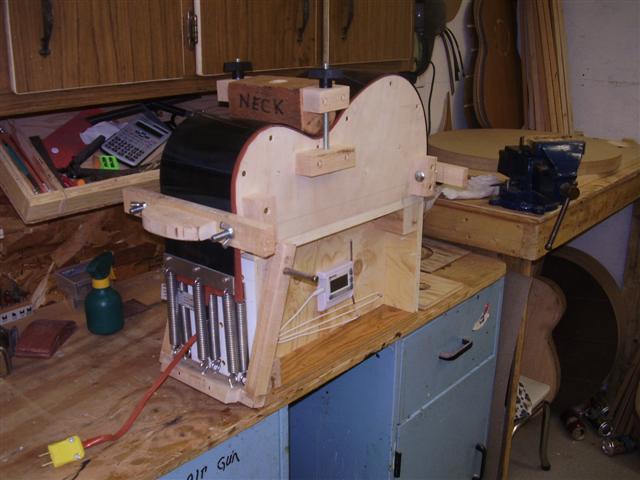

Well, i've never been very pleased with my side bender, it's a fox type but not as good as the real macoy or John Halls. And after breaking two sets of sides I knew it was time for a change......
I decided to make a Doolin style side bender as it looks fool proof to me (and I'm the perfect fool so I figured it would work great for me).
Now, I know that it's probably more complicated than is really needed for bending sides, but hey, there's always an other way of doing things right.
Mine is much closer to Mike's than Brad Way's was (post a couple of months ago) but both are based on the same spring princile. Thanks Mike for the cool design and Brad for posting yours, they both helped me build mine.

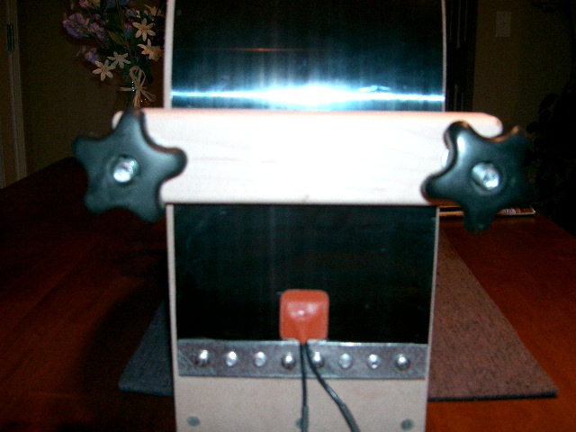

Anyway, since most everyone here want's to see pictures, I'll get on with it............

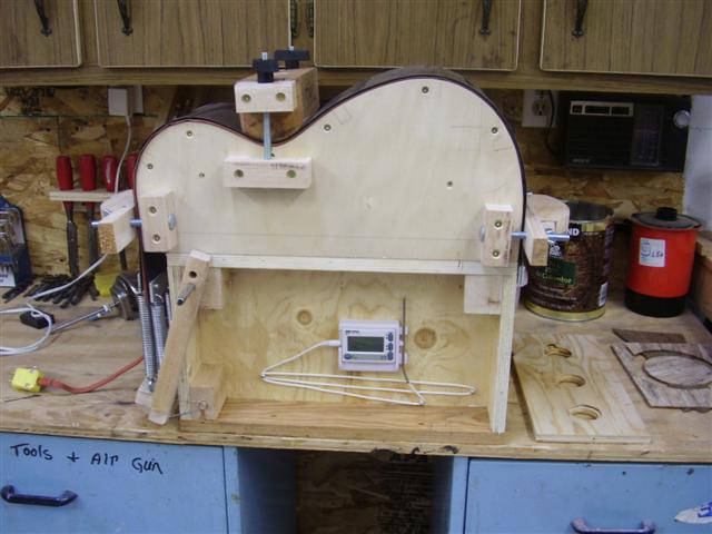

One of the additions which is very key in side bending IMHO is a way of telling how hot this all gets, so I got myself a good little digital thermometer with a long prob. It sure helped with the first bend.

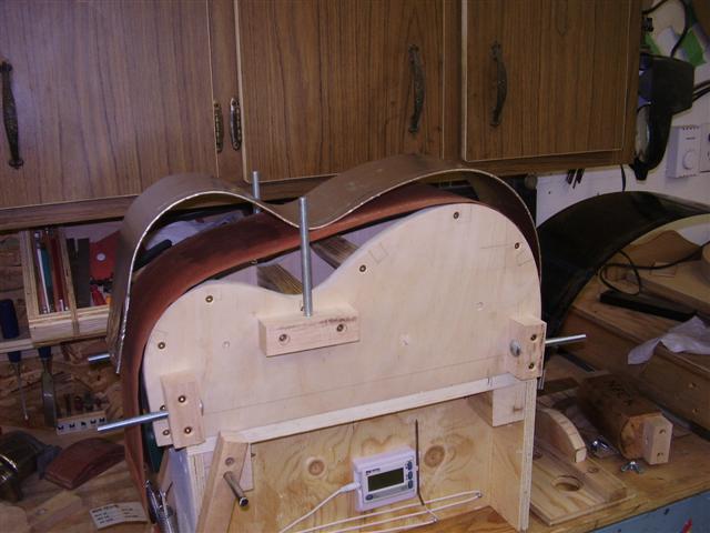

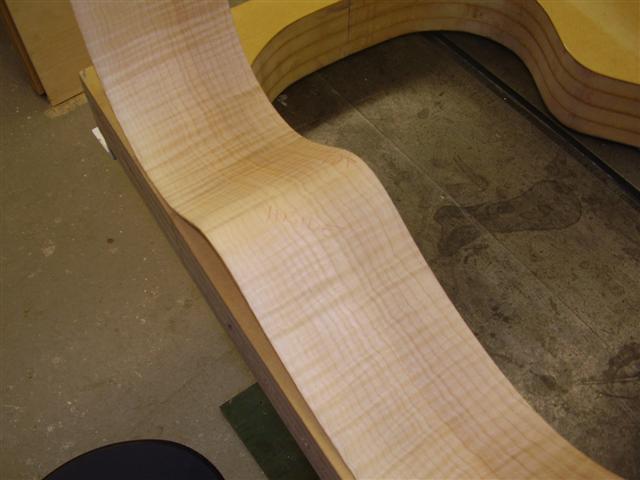

These are pictures of the first bend with it. A practice piece of curly maple. I figure this is a good test as it has lots of flame to worry about with the bend.
Here I am opening up the top slat, the wood didn't even move, it held it's shape perfectly.

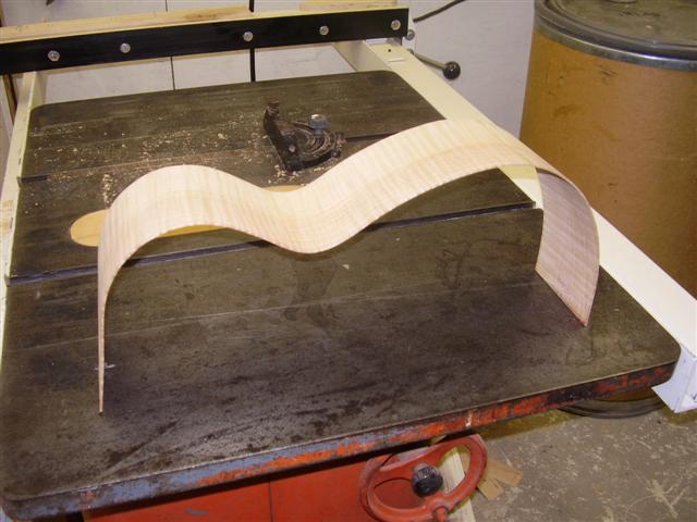

Out of the bender unwrapped
And no scorching
I compensated the inside form for spring back, but there was none so now I think I don't need to double cook it as I would like a little spring back or at least to figure out the correct shape.

What elements of this design do you think contribute to better, more controllable, reliable bends over the Fox bender? What about your old bender do you now think was causing the breakage? It looks like those springs keep it quite taut and was wondering what your thoughts might be.

Well JJ, I'm certainly no expert let alone barely a rookie even when it comes to side bending.
My first 4 guitars are all EIR which IMO was very easy to bend. The first was done on the pipe, the next 3 on the bender I made with light bulbs.
These next two I tried my original bender with the blanket, now, my guess is that I had several things wrong with MY design, not necessarily the Fox or Blues Creek design.
I did not have a support under the waist other than the spring steel which wasn't held by anything to keep it tight. Next my bout clamps were very very wimpy and when I tried bending the bouts, there wasn't enough support. Third, I didn't really know what the temperature was at. I just used the "spray the top slat and see if it sizzles" method, which may be fine, but something was wrong. And forth, I don't think I had enough water on the sides which broke. I think they were to dry and they just cracked because of this and too much heat maybe.
I'm really can't say if this is better than the Fox or Blues Creek design (don't even know the difference between the two), all I know so far is that this side came out perfect

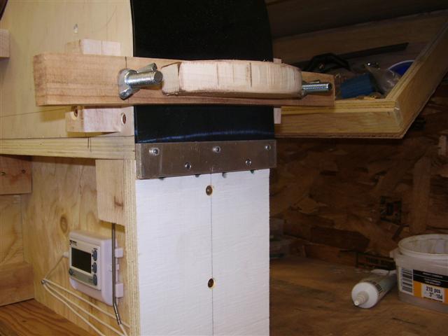

Now, this Doolin bender is clamped at the tail end of the form and the side is registered from there. Than the lower slat is pulled tight across the form, but not bent at the waist (see 3rd picture down). Next the side is clamped in at the tail end and pulled over the lower bout and upper bout with the top slat onto the blanket (which is hot of course) This takes about 2 minutes to do. Now the side is bent at the lower bout and the upper bout is pulled tight around the front curve but not clamped down hard. Next the waist clamp is screwed down (about 2 minutes also) which is supported by the tight lower slat. These are the bending instructions off Mike's web page and this side came out perfect.

Oh and the other part of your question regarding the location of the blanket. This is also Mike's suggestion and I have to admit, that I like it on the inside, just in case there is any chance of burning the wood, it's on the inside and much less noticeable. The other part of this is that when lowering the bouts, your essentially clamping the side to a hot form, remember the Taylor factory Friday video, they take the side which is cold and wet (wrapped) and bend the waist over a hot form. Same sort of idea I think.

Nice job Rod! I built a Doolin bender a few months ago and really liked the way it works (based on my limited experience). One thing I noticed when I was testing it was that the power cord for the blanket seems to be in the way. After my first bend I modified the bender so the power cord now comes out the tail end. Since the tail end is fixed it seems to simplify things during the bending process. Time will tell if it was a good modification.

Rod, I've been planning to make one of these myself. When permanently attaching the one end, did you include a spacer to accomodate for the heater and side? Or is that even necessary? Also, what size springs did you use (ie. length and diameter)? Finally, did you use the perforated steel like Mike Doolin used on his?

Question for you: on the end where you have the slats "clamped" together with what look like rivots; you aren't going through the blanket are you? It seams like that would be bad. I've seen several people rivoting the slats into a permanent sandwich but it looks as though the blankets are also part of those sandwiches.

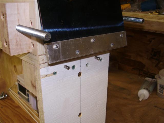

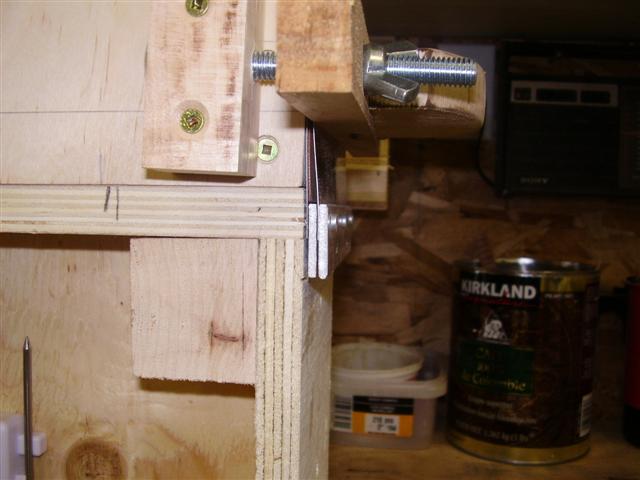

Don and Paul,
I made the "held" end with two pieces of 1/8" aluminum bar that I had kicking around, the layup went like this, slat, alum bar, slat alum bar.
I did not rivit the heating blanket in, that would be bad.
I made that end removeable as I thought that I would like to be able to take it off at some point and also, I didn't have as long of slats as Mike seems to have.
I have spring steel for both slats and drilling them isn't hte easiest thing, make sure you have a good sharp bit for drilling steel, not just a wood bit.
Here are somemore pictures of the held end if this will help anyone out.

Sharp...I got the spings from a local auto parts store, they are 9/16 dia x 4-1/2" long, you will have to make the base to accomodate the springs you get. I just tryed to pull the springs with my own power, if I could pull them than I thought they were not stiff enough, if I could just move them a bit that was good (real scientific testing there eh? )
