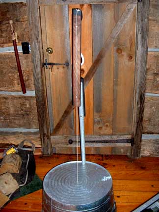

Washtub bass!!   one string, washtub, and a broomstick.
Here's one a little more sophisticated:
Washtub bass
Ron old man39032.690775463

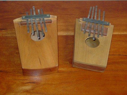

Michael, these I did with my youngest, side by side, one day in the shop. One day project, fun and easy to do, and they sound great. Use tines from an old rake for the thumb tone bars.
Have fun!
