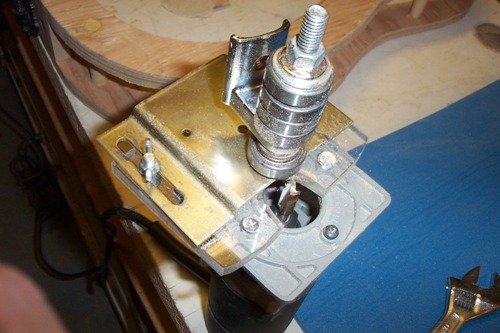

I'm in the exact same predicament as you, so I'll be watching this thread closely.
How long is the bit you're using? I notice that your 310 looks almost maxed out on height, and you've still got quite a bit of bit showing. I ran into the same thing, I wasn't confident that the router would hold it's height adjustment. I ended up attaching my 7310 and it worked out better for that. Kind of a bummer, because I bought the 310 to use on this jig. I did finally find a place that had a 2" long 1/4" downcut spiral bit, instead of the usual 2-1/2", so maybe that'll help.

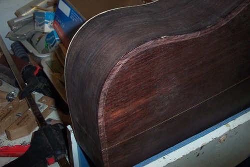

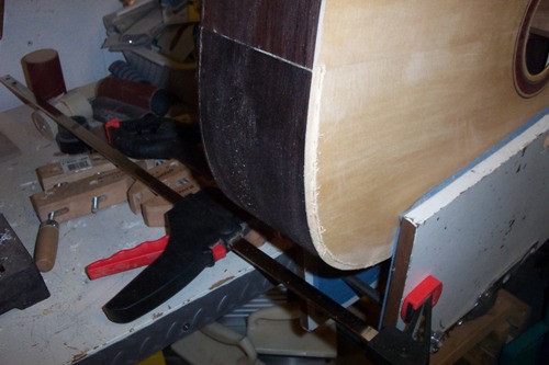

Hesh, i use my guitar vise for this and my home made jig that works much like your set up, take a look:

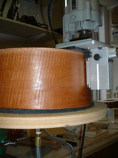

Build a vacuum holder:
The binding jig you are about to use works--I've used it for the last two years--but I'm not overly thrilled with it. It's time for me to invest the time in building a Williams-style jig, as Sylvan recommends.

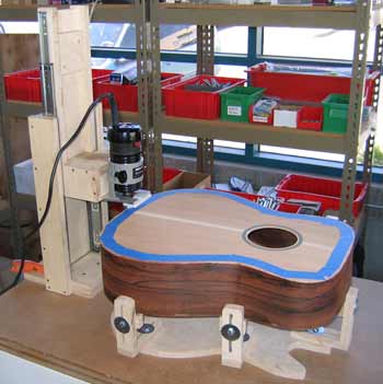

Russell came up with this neat body holding jig some time back.
Come back from your "other job" travels soon Russell - we miss you
By the way - I agree with Sylvan, the Fleischman-Williams is the dogs doo dahs
