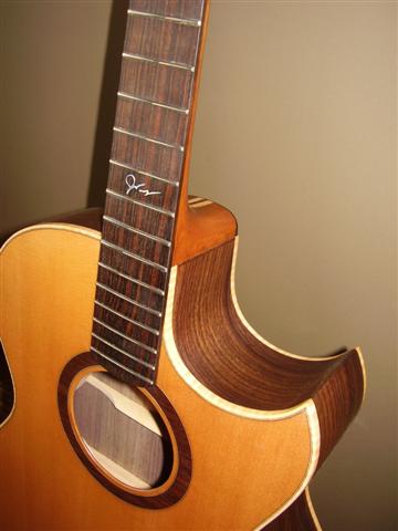

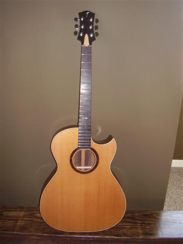

Phil, i've only built with cedar, granted that is only 4 guitars now, but I have had good success with the evenness of the wood once sanded. I do sand up to 400 though on the cedar, that sure makes a nice smooth surface for the sealer. What are you using for the sealer before the KTM?
I don't really know that much about finishing either, so all I can tell you is that I sand the top to a higher grit than the rest of the guitar.
Here are a couple of pics of the last guitar I built with nitro as the finish

rod, by the way - beautiful wood and guitar. thanks for showing that off and giving me good reason to keep sanding until i get it looking right.
