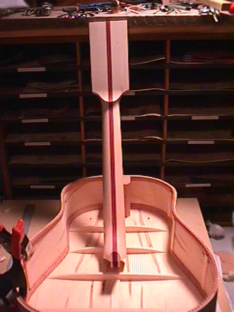

I posted the 4 guitars I have going right now a few weeks back in my batch and I am now finally to the assembly phase.
I purchased 4 sets of the Amborsia Maple recently and this is my first using it. Really nice to work with I must say, planes nice, bends well.
J-35 - Jumbo/Dread Style
B&S Ambrosia Maple Pink
Top - WRC with Spalted Maple Rosette
Bindings - Bloodwood BWB on the side and BWRWB on the Top
Maple Neck with Bloodwood Lam - IRW Fingerboard binding Bloodwood BWB
Spalted Maple Headplate binding Bloodwood BWB
Back Strip - Bloodwood

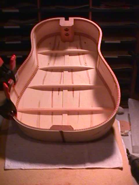

Inside the Box

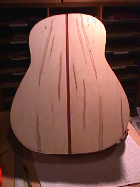

A look at the back

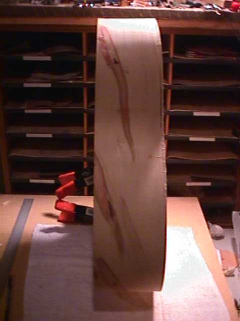

Side profile

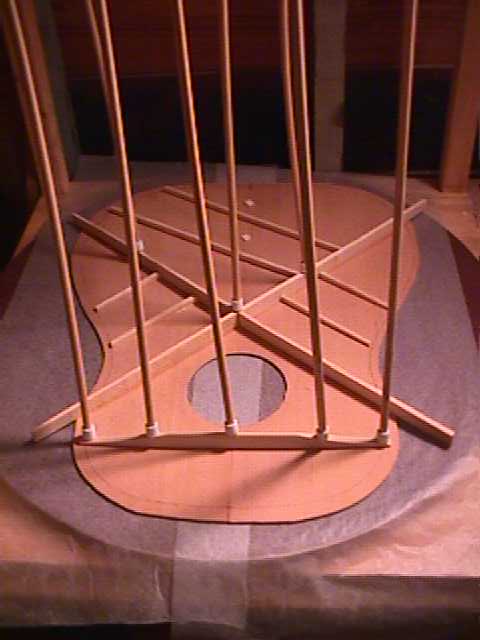

Here is the WRC Top on the Deck ready for final carving and shaping before it gets glued. This one has a Spalted Maple Rosette bordered inside and out with BWRWB purflings.
And finally the Neck with the Bloodwood Lam

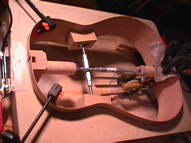

My next one is in the mold as you can see, everything is ready to assemble on it as well. This one is the Curly Cherry B&S with a WRC Top J-35.
In the mold glueing in the Tail and Neck blocks
I will close the box on all four and then start cutting the binding & purf ledges and install.

Richard, I use a light bulb Fox style bending maching that is less than stellar I can assure you. I was a little concerned as you can see from the figure on the sides about separation in the color grains from the maple. First, I took my sides down to .80 and sanded to near finish to around .75. I pre-heated the bender and when it got to around 250 (takes forever with bulbs) I spritzed and wrapped in foil, sandwiched between my slats and lined it up in place. I took the waist down about 1/2 way, and used my heat gun to add on low for the upper bout. My bending form (Blues Creek) allow me to move my pencil thermometer to different locations. At about 280 the wood gave to the slightest pressure so I slowly bent the upper and did the same on the lower. Once in place I let it bake for about 5 minutes, and then let it cool back to around 150 and then cranked it back up again to 280, backed shut the system down and let it cool to room temp. When I removed the sides I had only a couple of places with mild separation, no scorching and very little spring back. I placed it into my mold, squared my lengths off for a good fit. I used the LMI FCA glue, some wax paper and a clamp to lightly flood the areas of separtion covered and clamped just enough to bring the colored section of grain back flush. Be careful in clamping this Maple is pretty soft and will crush easily. Filling the little beetle holes was next and I mask taped the inside first and filled with FCA, let dry and then did the same in reverse, tapping the outside and filling from the inside. Sanded it all flush and all was well. Hope this helps when you get you new sides. Thanks for your comments

One more thing--I'd back up those beetle holes with a small cleat. Maybe on the inside?
PostPosted: Mon Nov 20, 2006 10:01 am
Steve, I have not forgotten, I will be getting back to shop time tommorrow afternoon and will shoot the rosette. I forgot to mention the small thin cleats, and I am placing them inside the box on mine.
