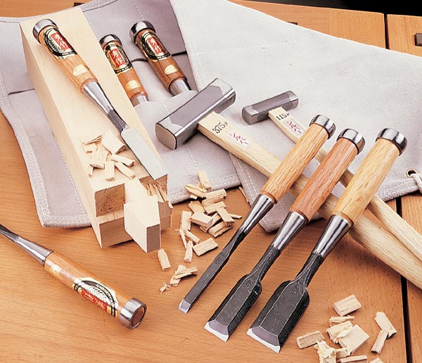

Lots of the Japanese chisels have laminated tips that have a harder carbon steel on top of the standard tool steel. I like that but it can tend to be brittle and chip if it takes a good blow.

What is the thinking behind the laminated tips - cost savings? Any advantages to this configuration?
Thanks![/QUOTE]
It's supposed to make the tips harder. Which is usually good but there isn't much give to it anymore so it will want to break if it takes a good blow.

the construction of the japanese chisels is based on the premise that the very hard laminated cutting portion of the chisel will hold an edge longer etc., whilst the soft iron body will be the shock absorber so to speak.

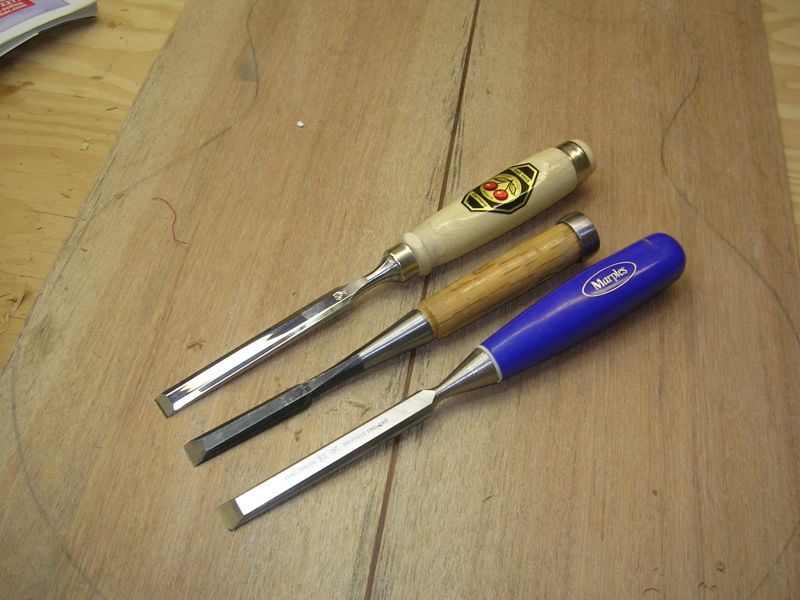

I just went though this. I had a set of Marples and I agree very good bang for the buck. I decided to upgrade though and bought a few each of different types/makers. I got a pretty good deal on a set of japanese chisels and they're nice but when it was all said and done I ended up buying the sizes I wanted and completed my set of Two Cherries. They come in a wide array of sizes and are about $23-$25 each.
I second the ideas stated above; If this is a first set and you are at all unsure of your woodwoorking future, buy the marples or equivilant low dollar chisels. If you are upgrading, buy the best you can and realise that you are buying a tool that will be handed down to the next generation... or sold and an estate auction, but that's a different matter...
Check here
Chisels
Best prices I've found and quick shipping. Those CI falls look nice but I've not heard any reviews...
One other thing to consider, if you are looking at Japanese chisels is that there is a marked size difference in similar chisels. The photo below is of three 1/2" chisels. The TC is 12mm the Jap is 12mm and the Marples is 13mm. They are shown on a back outlined for an OLF SJ.
I have average sized hands so both are fairly comfortable. If you have unusually large or small hands it could make a difference.

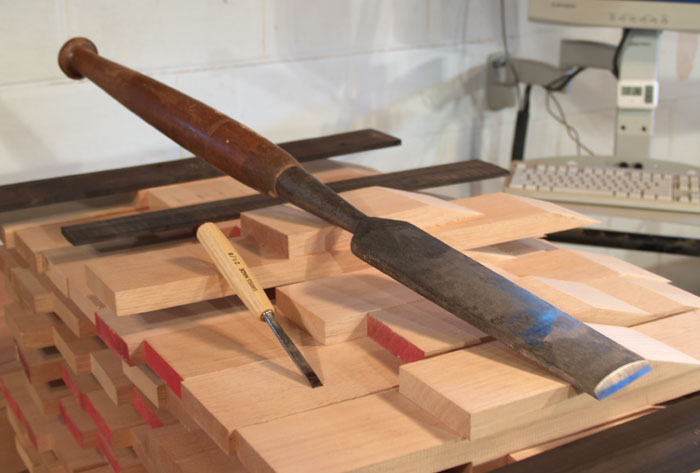

PostPosted: Mon Nov 20, 2006 6:43 am
that's a nice slick! thinking of going into the timber frame construction business?
