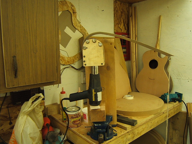

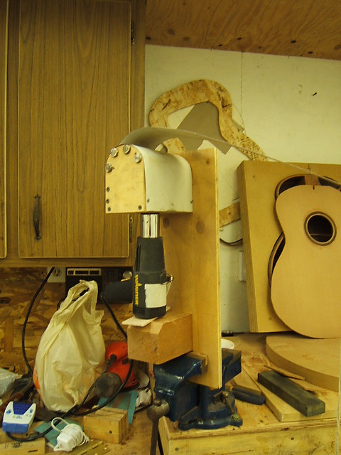

Here is my homeade one. I use a heat gun. I only use it for the sharp cutaways.

I would highly recomend using a Heat Gun instead of a torch if you have one. Orriginally I used a torh and then tried the heat gun. Heat gun is safer and gives great control over the temp. I also found a problem with the torch blowing out sometimes.

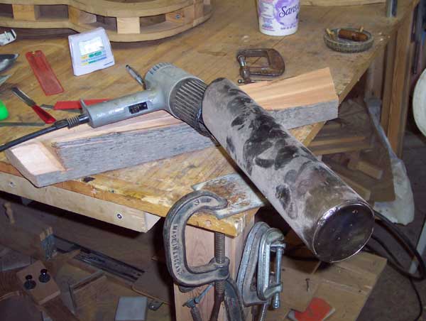

ditto on what Richard said above, my heat gun has a temp control, much safer than an open flame. I used a threaded piece of 2" oil field steel tubing with a cap.
