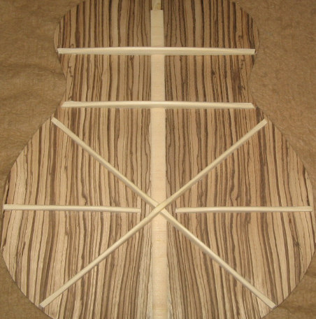

How about this...it is of my 2nd guitar. It is way over braced, but this gives you an idea. Good luck!

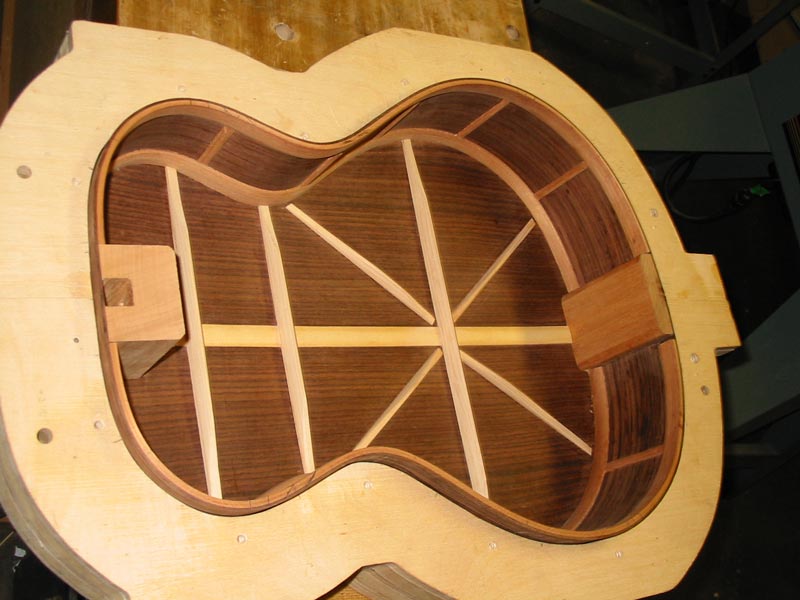

Crazytooguy I hope this helps. This my SJ design other wise know as the OLF SJ. This bracing pattern is on the OLF SJ Plans available from The OLF Library of Plans. The Snake wood cap was specific for this client
You will notice it is six sided star rather than just an X. this is to help support the extreme edges of the back at the apex of the lower bouts dome from wanting to flatten out.

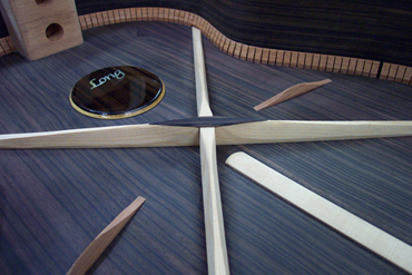

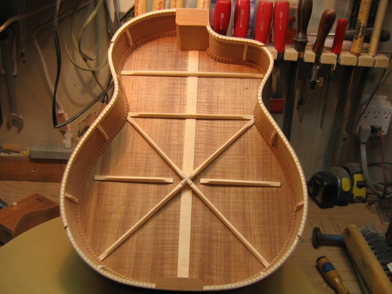

Here is my current build.
Similiar to Michaels but maybe a bit lighter. The cap is one piece maple shaped to an 'x' in place.

This is on my current build, I really like the result.
Greg

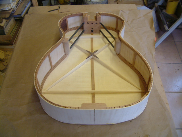

Here's more grist for the mill. Still needs final sanding, but very close to the final dimensions. X-braces are 3/4" tall at the center.

You have been at this a lot longer than I have, so I ain't claiming anything, but I got this design from Dan Minard....I let my x into the sides, it looks like you stop yours just before you get there...the details!
I sure like the looks of what Paul does too though!

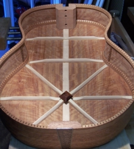

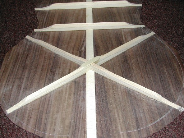

This is sort of a new design for me. I used something similar a couple
years ago on an ABG and really liked how it worked. This is for an SJ, I'm
not done with this one yet, so the jury is still out. The madallion is where
the lable will go.

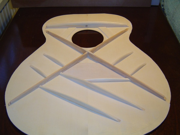

Scott, don't worry I'm an advocate of something approaching your system! As many here will tell you and noted by Bruce above I have been a great fan of "parabolic" bracing for many years. It is probably more popular on this side of the pond than on your's, as it suits the Celtic styles of playing and the more attacking modern styles of play popular here. I've built a lot of guitars that way and tune the top plate in a similar (though not same) way as you do. I don't say I fully agree with you on everything (we'll debate that another day!) but I think your work is both thought provoking and interesting.
By the way this is the top plate for that Walnut OM above, it will be my new dedicated DADGad guitar. As you can see we have ended up in the same ballpark, coming from different directions.
