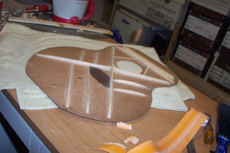

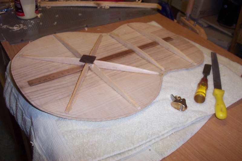

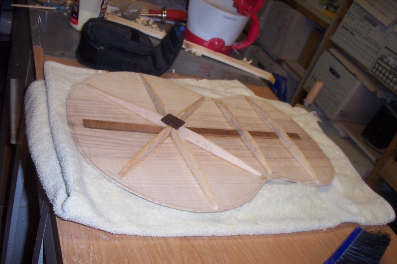

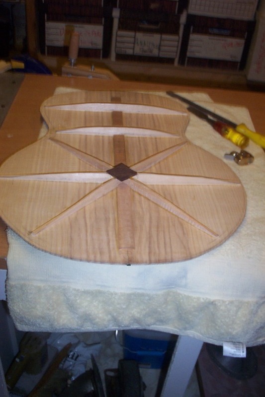

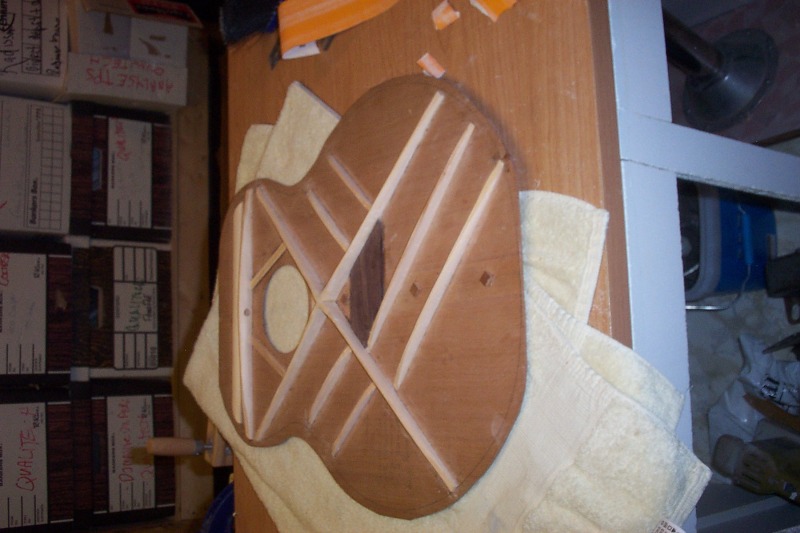

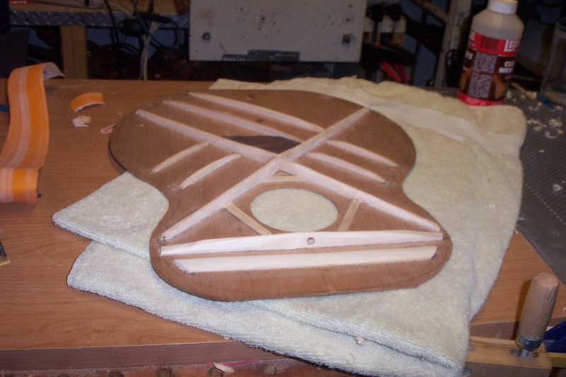

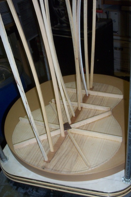

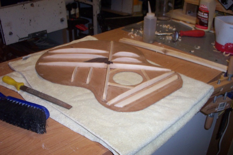

Hi folks, thought i'd post some more progress pics, i've been carving/shaving all the braces of the top and back today and all that's left is the sanding of the braces of the back and a bit of cleaning up, i've decided to go for the parabolas since i've heard a lot of good things about them. Both the top and back sound loud to the tappingbut a bit bassy especially on the red cedar top, i tried to make the braces very tall and thin, all critique is welcome, TIA
here it is:
The top braces
Glueing of the back center seam, i decided to go with an poff cut from the red cedar top, i kind of like the contrast. I also glued an EIR piece on the star brace
Back braces rough shaped, all i have to do on them is the final sanding but that will wait for tomorrow night along with the glueing of the side reinforcement strips
My definition of happiness! Thinnking of it, i just missed an opportunity to take a pic in it and calling it the Crazy "RITS"!!!!
Et voila!
Thanks for watching!

Serge, If I remember right, you thinned that top down to about 0.115+/- right. Which is thinner than most go with a cedar top, but that doesn't mean it's not stiff, it very well could be.
thinking about that and the fact that cedar is not as stiff as spruce, I would still say that the top braces look a little on the heavy side.
What are you base dimensions prior to shaping? This will help somewhat but of course it's hard to say what this will sound like without hearing the top.
I certainly don't have very much experience other than what I've seen posted by other more experienced builders here at the OLF and on other web sites and my own guitars (4 hardly counts for much experience indeed), so please take what I say with a grain of salt (or cyann pepper if you like it spicy )Rod True39043.9818518519

Thanks for showing us the pics! I'm certainly far from experienced as
well, but my first thought was what Rod wrote. I don't know about the
back, but the top looks heavily braced, especially in the fingers. If I
remember the pic Scott posted of his parabolically braced OM, the fingers
and tone bars were about half as tall as the X.

Thanks for the great response my brothers!
The finger braces really are tall but the pic doesn't show well how thin they are, i'd say close to ~ 1/16" thin at their peak, would you still advise to reduce their height considering how thin they are at their tips????
Thanks Rod, wrong numbers i had posted back then, don't know why the top was 0.130" thick at the edges and a bit more at the center last i remeasured, it does sound loud as it is but having no experience with it, i just rely on feel, perhaps Colin would chime in for his Bear?
Thanks James, took good notice of that friend!
Ron, yes, EIR bridge plate, thanks my friend!
Thanks brother Hesh, you were one of my influences on this, do you think that if i reduce the finger braces, the sound will be more balanced?
Serge Poirier39044.0392592593

if you're at 0.130" thick I would bring the braces down quite a bit especially the lower two tone bars and the finger braces. How high are they know?

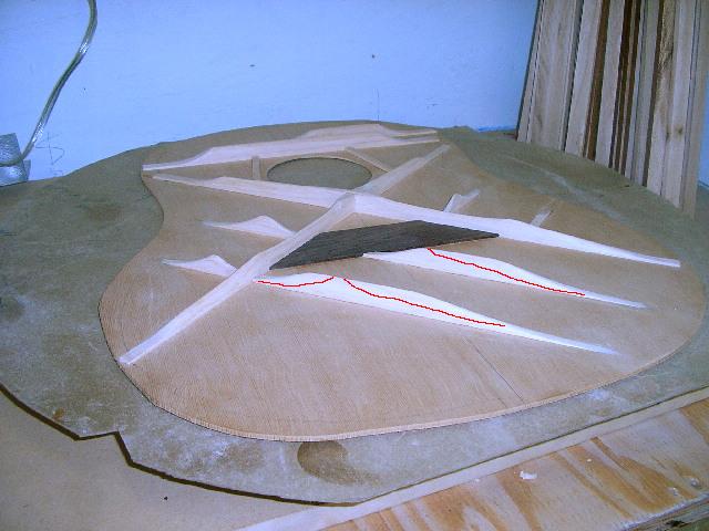

This is the bracing on my last guitar. The top is 0.127+/- thick.
I shaved the lower tone bars after this picture was taken as per the red line. The x-braces are 5/16" wide by 5/8" at the highest point (the crossing of the x brace. The tone bars are 1/4" wide by 1/2" at the peak.
I think that I could have gone lower on the x-braces after it was all finished up, but I'm always worried about taking too much off. The owner is still blownaway with the sound (I'm blown away that it's still together , just kidding)

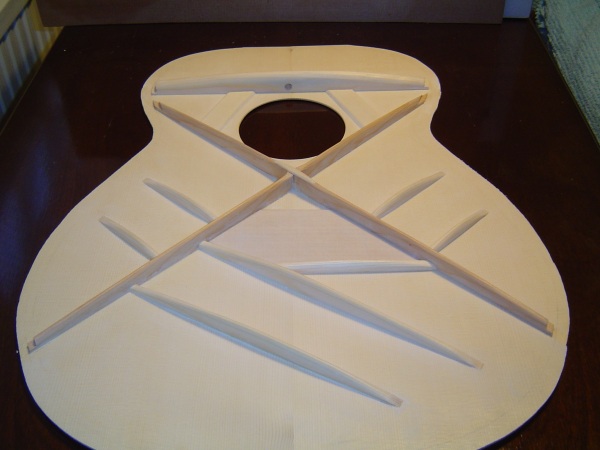

Serge the braces do look a bit on the large side to me as well, but better that than too small as has been said you can always trim them.

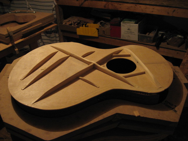

This is the bracing for my current OM, this is about my usual style, and size. All of these are 6mm thick, On this one the the X is 15mm at its highest and the maximum height of the highest tone bar finished up at 10mm and the highest finger is 7mm. This is an Italian spruce top. This one taps very clear right along all of the braces with no dead spots. I have great hope for it.
Don't forget though Serge, that all pieces of wood should be treated as individual so final heights etc will vary as you voice the top.
Serge PM me if you want more details of measurements profiles or anything else etc.Colin S39044.2541666667

Ok guys, i measured the braces of the top and here it goes on average heights:
TOP
finger braces: 5/8"      17 mm
Tone bars:     5/8"   &nb sp;  17 mm
X brace :      5/8"   & nbsp;  17 mm
What do you guys think?

So the tone bars I think you can bring down to about 7/16"
The finger braces could go down to 3/8"
and the x brace, well that's how tall I have mine at the tallest point, but you may be able to start your downward taper closer to the bridge plate and arc it down to the ends. Or you could be fine with what you have.
Of course as Colin pointed out already, no two pieces of wood are the same and it's all based on the top and ring of the top. That only comes with more experience.
With each successive guitar you build (and me too) you will get to know which brace to shave and which to leave. After about what 20-30 they will all start to sound better, so all we can really do is keep building and learning. Oh darn

Hey bud, here's a look at the bracing in no.3, which was pretty much the same as in no.2. At least you had a chance to play no.2 and you have an idea of how it sounded...
Not shown in the picture is that the braces are very thin...

I have braced to heavy in the past and the change to a lighter bracing approach was strange for me. I visited with some folks here on the OLF and have made the change. Colin sent me his size information and that was very helpful. I also moved more towards parabolic shaping. I took alot of meat off compared to past bracing and could tell a great improvement in tap sound.
I also tried a few other new things after some discussions here on the bracing
I tucked everthing above the soundhole and did not below on one, just butted to the Kerf at the same angle at contact, tucked just the bottom X on another, and tucked all the way around on the final (which is what I have done in the past).

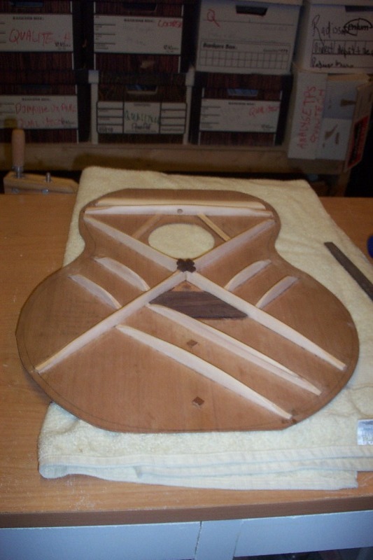

PostPosted: Fri Nov 24, 2006 1:33 am
Thanks Al, Charlie, Mike and Billy!
Gotta agree with all who support the idea of a lighter bracing, i'm now a convert! Thanks Colin, the difference in tap tone is HUGE! The info you gave me will remain in the shop forever my friend.
Here are a few more pics so you can compare with the first pics of this thread...
The tap tone went from loud to clear dramatically as i fine tuned each one individually, i think this kind of bracing is revolutionnary! Not sure that i will ever scallop braces again!
