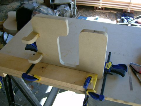

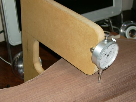

Charlie,
I made my molds and some other stuff from MDF. Check the link in my sig and you can see my molds. Here's a thickness gauge I made.
nay
