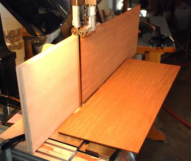

Well done Todd! Long hours, family demands and little shop time...I feel your pain    Great feeling once you get in there!!
I like your resaw set-up!
PostPosted: Fri Nov 24, 2006 1:40 pm
[QUOTE=ToddStock] [/QUOTE]
Incredible! You feed in plywood and it comes out bubinga!!! Resaw wizardry!!!
Nice, clean work, Todd. Well done!

Todd - what blade are you using from Woodcraft?
I was doing the same thing today, but was having trouble getting enough tension on the blade. I think the tensioning spring may be getting weak. I had the 3/8" Timberwolf blade on, and had it cranked up past the 1/2" mark on my Delta cast iron saw. I've never had to do that before. Brand new blade, too.

[QUOTE=ToddStock] Jim:
I think your instincts are right - the stock Delta spring is pretty fatigue-prone. I swap in a new Iturra (or Carter - same thing) - which is essentially a high grade valve spring - every 2-3 years. It helps.
With a sharp blade, I usually just run the tension to the 3/8" spot (between 1/4 and 1/2) and call it done unless the blade starts slapping.
Todd - Thanks for the pointers. I'm doing a big batch of Woodcraft bubinga (same as you I think?) I've never had to crank up the tension beyond the 3/8 mark before, so when the spring fails, it seems to fail fast.
