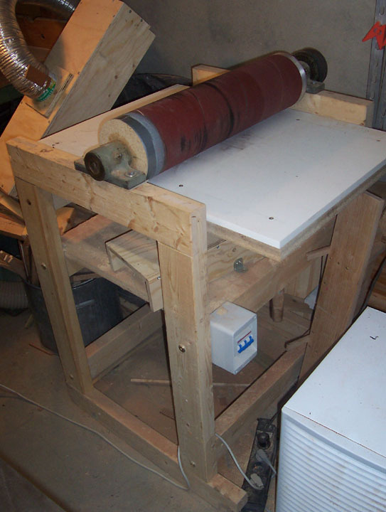

These things can be simple or elaborate as Michael says. Here is mine, clearly in the former category. I looked at several designs over on MIMF and elsewhere on the web, made some quick sketches and built this thing over a couple of nights.
The frame is mainly made from 2"x4" 's and particle board, jointed by simple mortise and tenons and a screwed on shelf to help with the stability. The motor is a 3 phase 1 1/2 hp, which is plenty of power for this machine. It has the "armstrong" feed type. It is important with a steady feed rate to avoid unevenness, but I have been very happy with my results so far and for my small operation that is what matters.
The drum is made out of particle board disks. It is 150 mm ( 6") by 600 mm (24") long on a 30 mm (1 1/4") steel rod with bronze bushing bearings. I happened to have this laying around, it is certainly sturdy enough! I made the drum by sawing a sheet of particle board into several square pieces of 150 x 150 mm, drilled a 30 mm hole in the middle, and cut them all into circular shape on my band saw with a simple jig that had a 30 mm "spindle". The disks were then glued to the rod with epoxy, and the drum was trued by slowly raising the table with 80 grit paper on it to the drum. The drum assembly had to be shimmed on one side to level it as much as possible to the table to avoid sanding it into a slight cone shape. The table is 3 sheets of particle board screwed together, the top one is melamine covered, for a total of 60 mm (almost 2 1/2"), with a piano hinge along the back edge. It has stayed nice and flat and true to the drum.
The dust cover is plywood, with glued in triangular wood in the corners to get is as close as possible to the drum shape on the inside. I use a 100 mm flexible pipe connected to my dust collector.
If you design the covers for the drum, pulleys and belts so you can't reach any moving parts, these machines should be pretty safe. The biggest danger is probably trying to take a too big bite at a time or trying to sand too short pieces, which can turn the sander into an extremely effective catapult (ask John!). Of course they also kick up a ton of dust, so a good dust collector is a must.
Here is a snapshot (with the cover off):

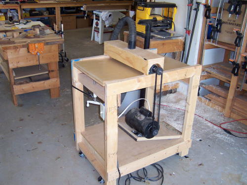

Mine looks almost identical to Arnt's.
Scrap wood. I turned the drum from a piece of 4x4 pine. It will sand up to 22" wide. I paid about $200 for a 1 1/2 hp motor (1725 rpm) and that is about the total cost. I covered the drum with velcro backing so it is easy to change paper. I've done three guitars now and haven't had to change the paper yet. Haven't had any problem with it kicking anything back, but I carefully check where it is set before inserting the piece to be sanded. The dust control works very well also.   I'm very pleased with it.

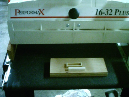

It also works great for thicknessing oversized nut and saddle blanks with the use of a carrier board holder type thingamajig.

a very simple crude jig. Flat board with a sort of fence made of thin scrap glued around the roughed blank.You can add as many blanks to the board as you wish I do it 1 at a time as to not waste material.It works for me.Get close to the thickness and finish by hand for the final fit.Hope the pic came out if not I will try it again. Hope that helps.
Tim
that is an oversized nut blank in the pic but will work for saddles to.you can make the board longer if you want I barely hit mine with the drum so it is stable.never had it shoot out of the sander.Didn't think about it while taking the picSorry about the orientation it should go in the sander lengthwise TimDet39049.9272337963

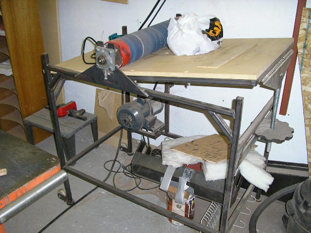

I have a semi-home built sander. I drew up the plans when I worked at a steel fab shop and some of the guys built it for me. It has a 5" machined steel drum and all steel frame and support for the deck. right now I have a 3/4" MDF on it, but think I need a second piece with malamine or laminate on the feed deck. 1hp motor, need beter dust collection though, but the large shop vac is ok, just wear a dust mask and run the air cleaner.
Here's a pic. The cover is off it here as I was probably sanding the ends of a bridge, it's handy for that.

J. it is 1:1. The finished drun diameter is just under 4 inches, and the speed works well with b/s or tops. Actually it probably is 4" with the velcro and sandpaper.
