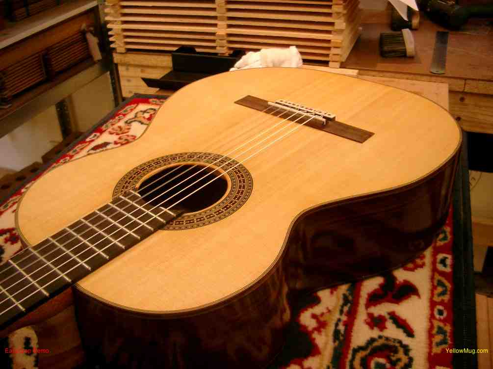

Back from a 4 week hitch on a rig off the coast of New Zealand and have been busy in the workshop trying to get the classical finished. Finished off the FP body coats and got the bridge glued on and set up the instrument. Not one buzz or rattle....I cant believe it. The instrument is based on one of Torres guitars and has IRW sides and back and a Sitka spruce top. Neck is Spanish Cedar and rosette is a stock standard ready made one from Stewmac.
The sound.....fairly balanced with a slight bias towards bass, Volume and sustain are surprisingly good for an instrument of it size and neck mass.
In case anyone is wondering about the serious look on my face...Im waiting for the bridge to pop off and go flying past my ear.

Martin, nice, very nice. which Torres guitar is this based on? I've just started a guitar based on FE19. There must be something about geologists and Torres!
Can you post a sound clip?

[QUOTE=jtkirby] Martin - very nice! Now you'll have to learn how to hold it
(Actually, I was surprised how comfortable the left leg position is once you get used to it. It gives you a lot more access to the really wide fretboard.)
Jim [/QUOTE]
Jim, you must be a teacher! Im holding the thing a bit precariously because the shellac is not rock hard and Ive also got a few issues with my back at present...sitting is not good for it.
Thanks for the positive comments guys.
Cheers Martin
PostPosted: Sun Nov 26, 2006 9:07 am
Posts: 1055
[QUOTE=Colin S] Which Torres guitar is this based on? I've just started a guitar based on FE19. There must be something about geologists and Torres!
Colin, the design came out of Courtnal's book. I'll have to haul it out and check which Torres model it is.
Cheers Martin
PostPosted: Sun Nov 26, 2006 9:18 am
Martin, do yourself a favour. If you haven't already got a copy go out and buy Romanillos' book on Torres. It'll be the best money you ever spent.
PostPosted: Sun Nov 26, 2006 9:31 am
Posts: 2990
Martin,
Congrantulations.
Looks really nice. How do you like sitka for a classical top?
PostPosted: Sun Nov 26, 2006 9:55 am
Posts: 1055
[QUOTE=Colin S] Martin, do yourself a favour. If you haven't already got a copy go out and buy Romanillos' book on Torres. It'll be the best money you ever spent.
Colin, Romanillos' book was added to my library a long time ago. Yes, it is an excellent book and the story of Torres life is a fascinating one.
PostPosted: Sun Nov 26, 2006 9:58 am
Posts: 1055
[QUOTE=Jim_W] How do you like sitka for a classical top?[/QUOTE]
Sitka an easy wood to work with and the tone is good. My next instrument will be of similar design but using Englemann for the top, just for comparison. Ive got a pile of red cedar that needs to get used so I guess classical No 3 will have a cedar top.

So have you been bitten by the Torres Classical bug...once infected it will be hard to think of building a steel string or at least that is what happened to me

I'm interested in your next two builds, and what your impressions of the differences are between the different tops. It takes a brave man to put Sitka on a classical.
I'd like your thoughts on how it compares with the Engelmann. Can you have that done in a couple of weeks?
