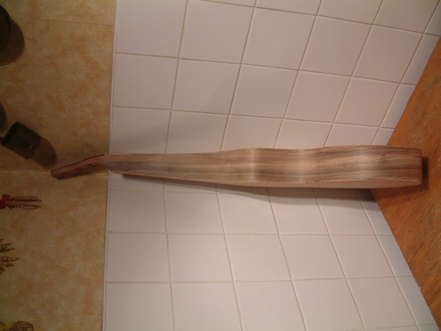

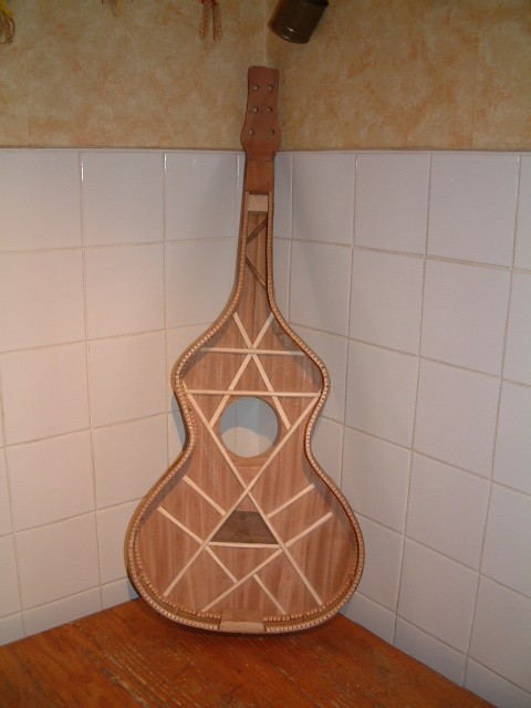

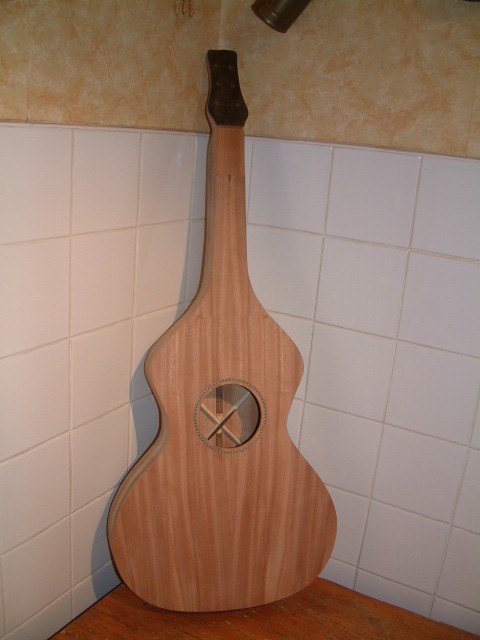

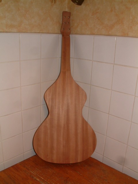

Here's some pics of the box as is (4 piece Sapele top, 4 piece Sapele back, English Walnut sides, sapele pegbox with Braz R/W headplate). The bracing is an adaptation of my normal pattern and the top braces have a 13' radius, back braces 10' as per my normal builds. Sorry for the poor quality of the pics.
Front view:
Back view:

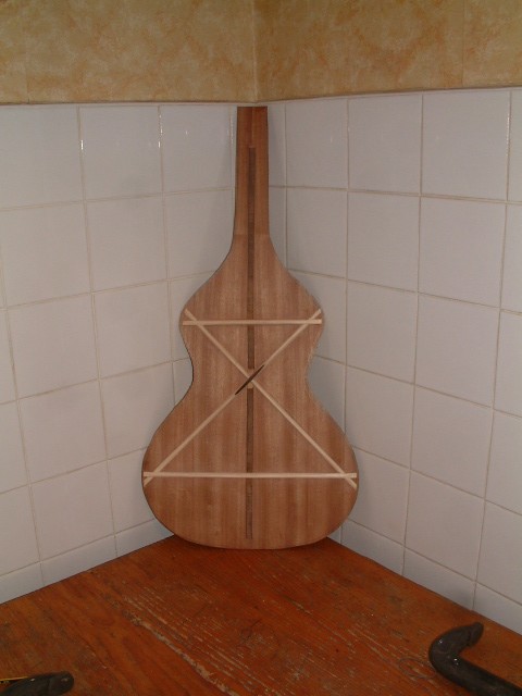

From soundhole down it's like any other guitar so I didn't have much problem there. Above is a different story though with no neck block as such. I like the way the A frame works and as the apex is at the neck-block of my "normal" guitar I thought why not continue the A to become an X - giving the fingerboard support here. Then another X above and then you're into the sides giving the fingerboard support via the hollow neck. These braces are 8mm wide by 6mm high and I've kept the profile square. Then for good measure there are a couple of CF pieces going diagonally across the neck, hopefully to help resist the string pull and keep the neck flat. Mind you with the box closed the whole neck area feels really stiff and strong.

The bracing pattern of traditional Weissenborns - both top and back - just looked over braced to me and I wanted to experiment and see how the bracing and top/back arching that I use would translate to an instrument like this. I strikes me that I would be looking as much for tone and responsiveness with a Weiss like any other instrument. The bit that has me thinking most is the part in front of the soundhole. I thought of using flying buttress CF braces from the sides near the waist to the sides at the start of the neck but am trying to do this one as much as possible (apart from binding) from odds and ends left over in the workshop.
