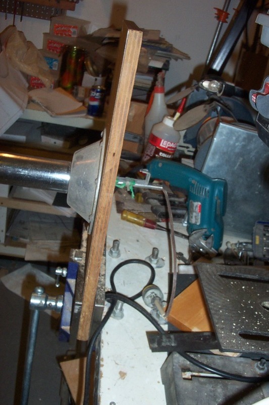

Sure Sis! Just looked through my photo files but can't retrieve it , i will take another pic later on and post it here!

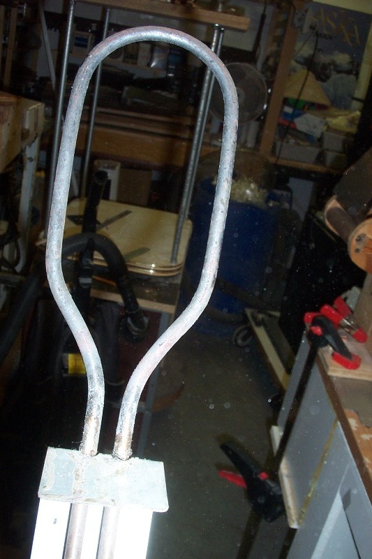

Sam I use a heat gun for my touch up pipe (2" piece of SS with a cap on one end) and my cutaway bender. I havn't tried it with the router reostat yet, but I bet I could control the heat that way.
Here's a pic of the cutaway bender.

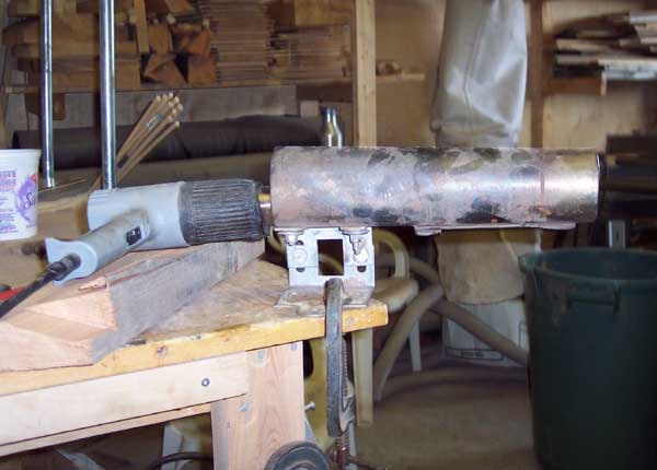

Here is my cheapo pipe. I use a heat gun, used to use a torch but prefer the gun now

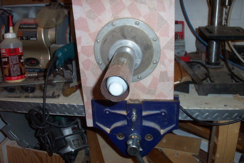

Oki Sam, finally got a pic or 2 for ya, sorry for the delay!
my cheapo pipo thingie
But this is what i'll be using from now on!
PostPosted: Sun Dec 03, 2006 1:19 pm
Posts: 749
Rod, My Heat gun (bought it at Canadian Tire for about $30 years ago) has a high low switch and I find between the 2 settings I can always get the perfect temp. I just heat it up on low till water dances on it for Maple and similar woods or on high until water evaporates right off for Rosewood. As I said I used to use a torch but find this much safer and the temp is just right.
