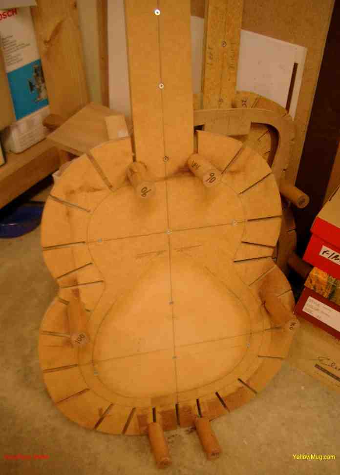

For my next classical I'll be using a solera....a workboard with a hollow sanded out in same extending from bridge area to soundhole. See Courtnall's book for details on making a solera. Not sure on the exact radius of the resulting top but maximum height of the sound board doming is about 2mm above soundboard rim...I guess its in the vicinity of 25-28' radius.
With the rim you have a choice of leaving the area flat or carrying doming of soundboard right to rim. If you have the top curved right to rim then youll have to shape the tantallones or lining when you glue the sides in. If you leave the top flat about 25mm in from the rim then it makes gluing top to side a bit easier. Again this is explained in Courtnall's book.

Most descriptions and plans I have seen suggest that the tone bars have flat bottoms, and all the doming is in the lower bout. The doming in the Courtnall solera is all below the soundhole, starting near the lower tone bar. Top rim is flat. On the three Rodriguez-style bodies I've built, all the main top braces are flat. (These were all built on the Courtnall solera).

Heres a pic of the solera I made up for my next classical.
Cheers Martin
