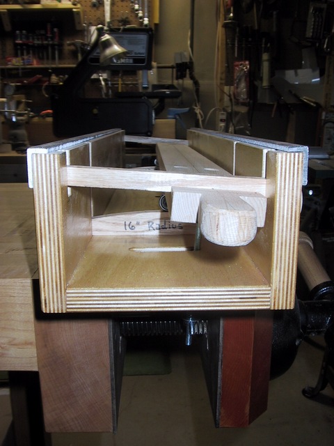

This shows the jig mounted in a bench vise ready for action.

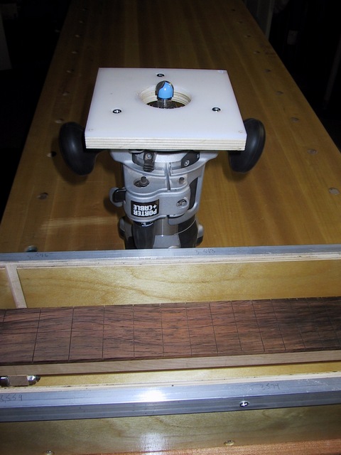

I made a simple square router base lined with UHDMW polypropylene to allow the router to slide securely and freely within the track. I found that the round base was too easily tipped and bound as it traveled. The router bit is a 3/4" core box bit from Rockler.

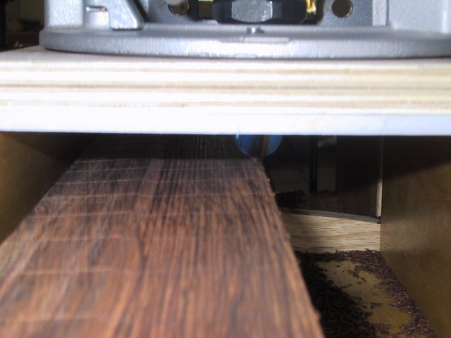

This shows the FB half done. It took about 20 passes to get this far. I indexed the carrier board about 1/16" for each pass.

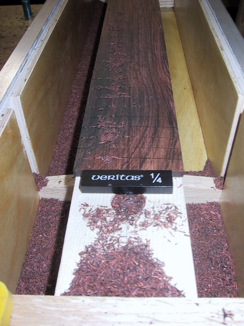

This is the completed board. Just a light sanding with 100 grit was all that was needed to smooth out the machine marks. I used the 1/4" setup block to adjust the bit height before starting the operation.

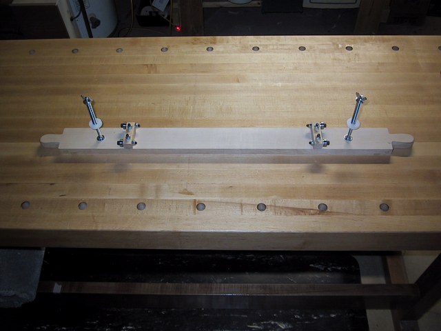

What hardware connects the inserts to the carrier board?
Could we get a look at under the carrier?
How do you secure the FB onto the carrier?

Just to make sure I'm understanding it correctly ... the router rides on a flat guide, and the fingerboard carrier is hand-held, sitting on the radiused guides on each end and then moved back and forth across the width of the fingerboard. Right?
For the sake of the next question, picture the jig in front of you with the fingerboard oriented left-right. To use it, you'd push both fingerboard sled handles away from you and toward you. What inaccuracy is introduced if the left and right handles are not perfectly in sync - that is, if one handle is further forward or back than the other?
Thanks for your help in understanding this baby!

Far as I can tell, its a box with radiussed inserts that slot in, with ball bearing runners (two each) running along the radii. Are the covering 'slats' at the two ends to hold down the carrier board while routing (longitudinal direction)? I've drawn up similar plans before, but its the locking down that always stopped me from building one like this. Have you tried it with a compound radius board (lets say an extreme-ish 12-20" progression, which I want to try for my electrics)? how do the bearings deal with the longitudinal diplacement involved in a compound radius? Is there much/any? Does it take fingerboard thickness (even down the edges, not down the center) into account?

Here's a shot of the underside of the carrier:
The 6" carriage bolts are connected to the carrier and pass through the base thtough 2.5" slots. They are held in tension by compression springs and wing nuts and 3/16" thick x 1.25" UHMW washers ride on the bottom of the base.
Wade...The FB is secured to the carrier by 4 pieces of 1" double sticky tape. The radiused inserts slide into a slot on the sides and are just held in place by the slots.
Pete...The carrier is indexed laterally while the router travels longitudinally. By tensioning the carrier bolts securely from below and being guided laterally via the guide blocks, the carrier actually indexes fairly evenly. It's always possible to take more passes than I did but it seemed to work well during my first trial.

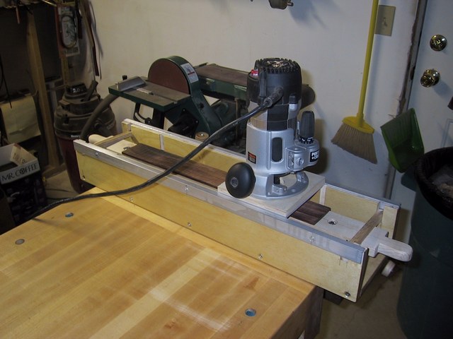

Here's another shot that might further clarify what's going on:

Chris...perhaps I didn't describe this clearly. The carrier is indexed 1/16" and then you take your hands off it. You then put your hands on the router and move it lengthwise. It's not necessary to have hands on both components at the same time.
